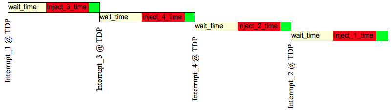

I do have a coding issue I think, since I am not a coder but a mechanic I used an interrupt to drive the injectors directly with timers attached.
I did got a (digital) beating for that and understand why, if a timer connected to an interrupt is still running when a second interrupt is triggered I have trouble right?
Is there a way to let an interrupt trigger a subroutine so it gets freed immediately and the routine keeps running? (like in bash $command &)

I know it is not threaded and that is why I am concerned.
Main issue is that I want a calculated injection moment, the only stable factor is the end of the injection in degrees. (so in time dependable on rpm)
To make live easier when mounting/adjusting I like the distributor to give a pulse at TBP since that is the only position of my engine I can monitor. (with head in place)
So with cylinder 1 at TDP I have a starting point for injecting cylinder 3 (order 1342)
I have a time interval in us between 2 interrupts so I can calculate delays but main thing is that the interrupt triggers actions with delays where the end of that cycle can be after the next interrupt is triggered. (due to revving up)
I don't see a software solution, only thing I can do is mounting the distributor to the throttle cable and let the interrupt trigger injection without delay.

Thanks, I understand this way of handling.
Instead of putting waits in the interrupt you used a compare to see if it is time to close, but does this change behavior when 2 interrupts overlap each other?
I attached an image to explain the situation:
Each injection has 3 values: delay_from_tdp, injection_duration and remaining_time_to_next_tdp
When rpm is steady the green time is free time for the uC but when revving up it can happen that the next interrupt trigger is before that free time so it is triggered when the previous interrupt function is still running.
That don't have to be a problem since during injection there is no action, only a wait time so the start of the next cycle/interrupt can only add a couple of cpu cycles to the injection time.
Main thing I am afraid of is that if an interrupt function is not yet finished the next won't start or the first is not closed due to the overlap, that is why I was asking about the bash & solution. (free the interrupt while the injection cycle remains running)
I haven't had much practice using interrupts() so my sketch may have issues. In this sketch, the interrupt sets a flag to true. The function then runs only if the flag is set. The interrupt is done the moment the flag is set. The inject function resets the flag from "true" to "false" so that it can be set again on the next interrupt.
Each injector has it's own flag and will have it's own function.
The code is mostly written for the cylinder1. You will need to review it and see if it can be used for the rest of the cylinders.

OK cyclegadget, that is clear:
The interrupt sets a flag, inside a loop the flag is detected and an injection subroutine for that flag is called.
One advantage of that approach is that I have to concentrate to make the loop as fast as possible since reading ADC and doing calculations in that loop could disturb injection start. (so it is more clear how many cpu cycles things use)
It does however raise another question (which also exist with any other approach), when the inject1 routine is called from within the loop what happens with the loop itself?
If if(currentmicros - previousMicros > Delay && InjectorState1 == HIGH) is running will the loop be stalled until Delay matches the micros calculation or will it keep running during every free cpu cycle?
It would have been better if the variable called "Delay" would be the words "on-time-needed" . Basically, it is like you look at your wrist watch noting the time as you turn the injector turn on, next you walk off to do other things and when the time has elapsed, you stop long enough to turn the injector off then, you go back to doing other things.
Clear!
Before writing final code I will add timings to every part of my main loop to see how much time is consumed on every part, based on that information I will create something final.
Thanks for your help, I will post again if I have something working and on every step I take for the record. (calibrating injectors and timings)
I think you are on the right track and your project is very doable. I can wait to see your progress. I will help as much as I can.
Hello cyclegadget,
The parts for the injector and pump driver print are ordered so next week I can start with building the hardware.
Did some coding last week based on your idea, do have a question about it:
In the injection function you use done=0; and done=1; and at the end return done; why is that, for usage in messages when serial prints are added?
I did change things a bit, I moved time reading stuff directly into the interrupt function to make it more accurate.
Also I changed the way U used time based checks for start and stop injecting to add a "delay" before start injecting and to make it a bit more clear on when things are happening.
