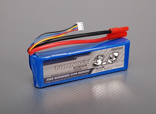

That battery is not intended to be a flight battery. It is a transmitter battery, intended to power a transmitter with very little current demands compared to powerful motor like you specify.
If you pull more current from a pack that it can safely deliver, it gets puffy and has a reduced capacity from that point on.
You want a battery that is designed to be a flight battery. You have 4 big motors that will probably be turning big props. You need to find out how much current, like @NewStudent said.
The motor specs say 20-48A for efficient flight. 80A max. Times 4, that is a lot of power.
You will need larger packs that that one. Likely multiple packs configured in parallel to be able to handle a large current demand like what you are planning.
Here is a 3000mAh pack that can safely provide 40C
You likely need multiples in parallel.

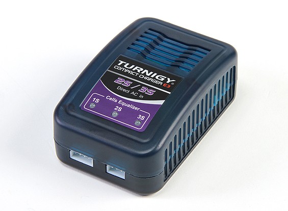

This is a cheap charger that can plug in to the wall and charge one battery at a time. Likely will take more than an hour to charge each battery.
There are more expensive chargers that can charge faster, and multiple batteries at once. Most of them do not plug into the wall. The require a 12V power supply.
