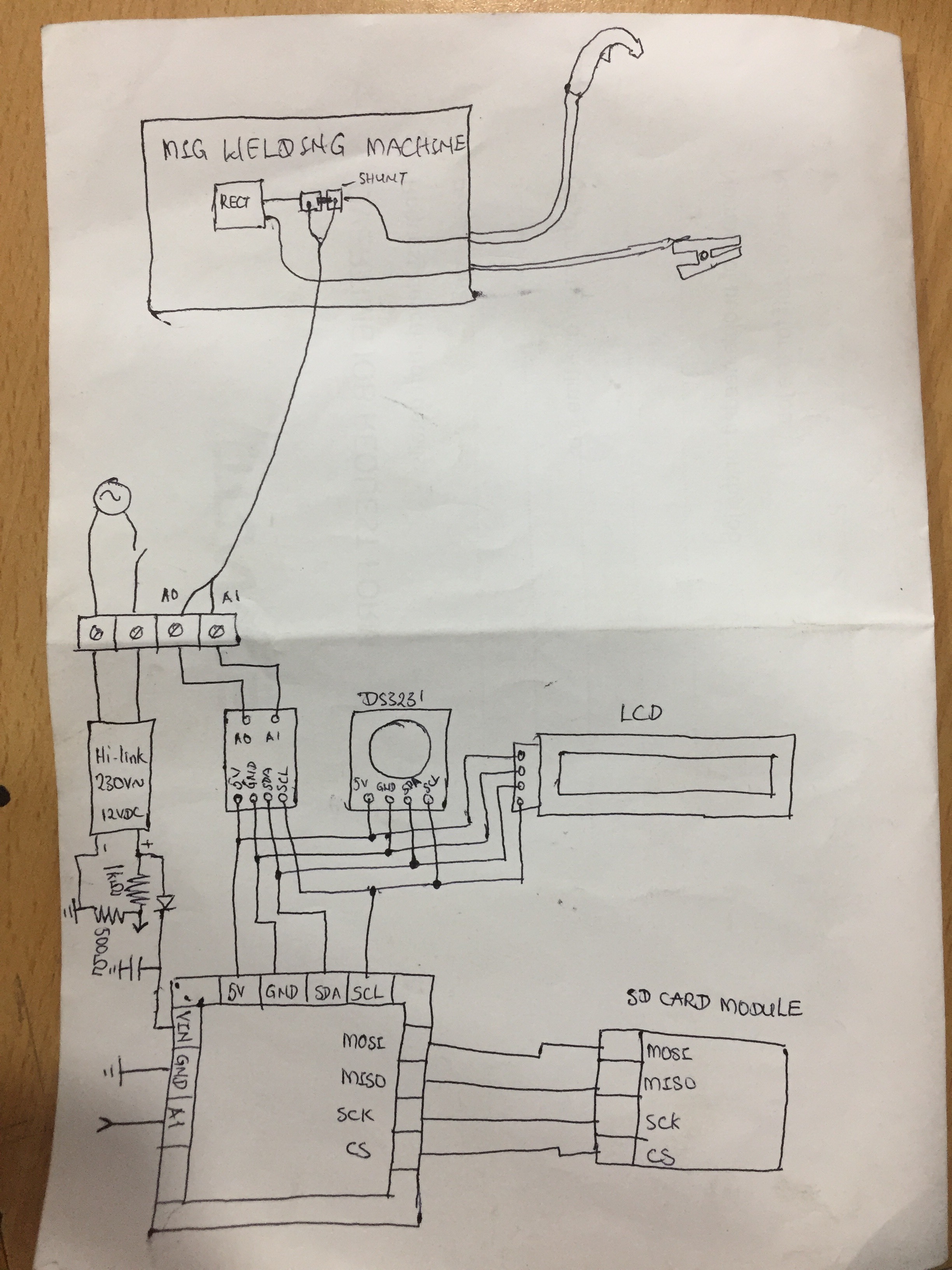

On connecting it to the designated machine (MIG welding machine), while the machine was working, the LCD screen sometimes goes off, or it goes blank or shows gibberish characters, and also, the Arduino Board freezes.
How is it connected? Could you provide a circuit diagram?

Here is the schematic
There's no isolation in your current measurement circuit (shunt/ADS1115).
Should use an isolated current transducer or current probe.
Do you mean an opto-isolator? If so, what kind?
An opto-isolator is one way to isolate digital circuits but is not so good for analog measurements. An isolator for current measurements would be a current transformer, a Hall effect device, or something else.
I suppose that if you had an isolated power supply, you could make an ordinary measurement of current using an ADC with a serial output, and use an opto-isolator on this serial output. Seems a bit complicated when you have an Arduino with a built-in ADC to use.

I used an ADS1115, to get current readings from the shunt, wouldn't that be "isolation" in a way?
Here's a link to a non-invasive sensor project that uses the ADS1115 module.
Sorry, no.
By "isolation", people are really talking about "galvanic isolation". The ADS1115 does not provide any of that.

What if I put decoupling capacitors on the A0 and A1 of the ADS1115, can that help?
The I2C bus on the ADS1115 is going to be difficult to use with an opto-isolator. The clock is (usually) unidirectional and can use an opto-isolator, but the data line is bidirectional. Unless you get an I2C buffer that separates out the two directions, it is going to be quite difficult to use an opto-isolator.
Even if you have an I2C buffer that separates out the two directions, you are going to need an isolated power supply and TWO opto-isolators (one for each direction).
This sort of planning normally occurs PRIOR to operating electronics in the vicinity of a heavily EMI-producing device. I am sorry that you are having to do it now.

See below the AC to DC converter I am using
That AC to DC converter is great but I did not see anything on the data sheet about it being galvanically isolated. Maybe it is, maybe it isn't, but manufacturers usually want to get this sort of information onto the data sheet if the information exists.
