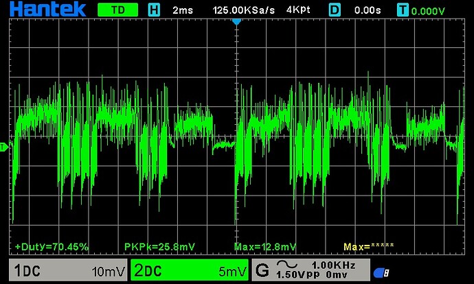

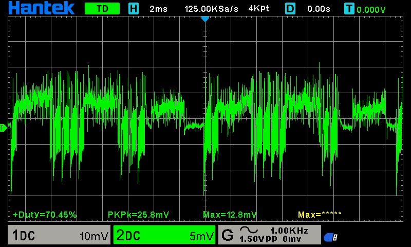

VCC measures as 13.56, all grounds are commin. Circuit is as described in the first post. Here's a link to some images taken with my oscilloscope with measurements. Yellow is the output from VN750 (not turning on) and green is the input coming from the PCA9685. While the two folders appear to have similar images, note that the measurement info at the bottom is different.
Here's a link to some screenshots from my oscilloscope if it helps at all.
Also, there are 4 of these drivers on the board and every one does the same thing.
Without a reference line (0 V) the screenshots are of little help. Why different folders for input and output if you have a 2 channel scope?

The arrows point to GND/Ref.
Let's see an ESP output, then the ESP output conn'd to the PCA in, then the PCA out vs. the PCA in (all of that free of the VN750 assembly).
If you refer to my last post...
While I did not include the min voltage, one can assume that the voltage doesn't go negative and that, with DC voltage and a square wave, the reference line for 0v is at the lowest point, where the marks are on the left that say 1 and 2. Just because there isn't a line across, doesn't mean it isn't marked. The second green mark was a T, which was just the trigger setting as this oscilloscope has a trigger output. Thank you for pointing that out @runaway_pancake.
