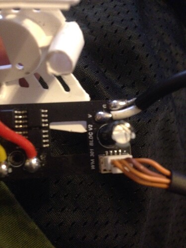

Hi, can you please help me with some Advice/Tips on Esc Brushless motor. A while back I found a pretty damaged Phantom v2 that I would like to rebuild when I acquire more experiemce. Meanwhile I would like to check(play)for functionality of the Esc motors(p1:1khz, p2:gnd, p3:motor control from flight controller 400hz p4:motor control from flight controller 400hz/..37%duty cycle=off, 47%=idle, 71%=full throttle ). Researching has left me confused and not sure where to begin and would appreciate any advice sent my way.
