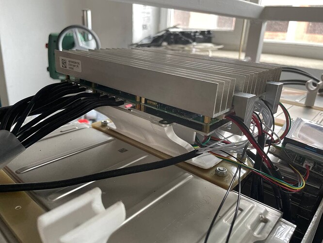

In the mean time, I used an RaspberryPi Zero w (has bluetooth and wifi built-in) I posted the modified code on the other forum where I found a python script made by someone else, but that used grafana and influx database, instead I needed to send the informations from ant bms to my local server trough http requests.
It does work great so far, I only tested a few days, and today or tomorrow I plan to bring the battery from my workshop to my house, it's quite heavy at ~160kg
