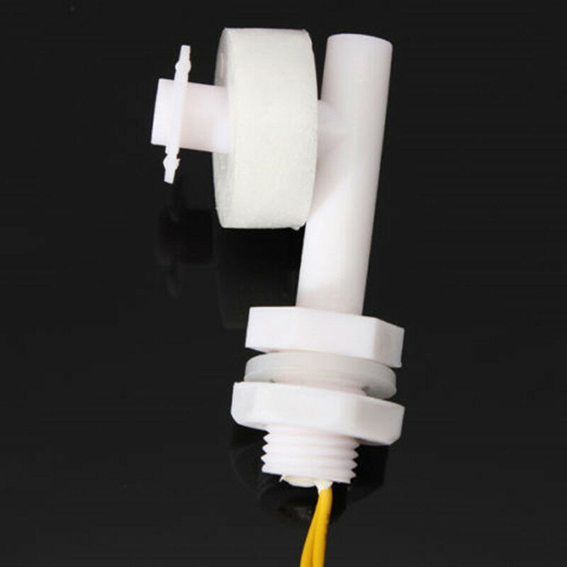

Basically I have an AC installed in a room that doesn't have access to a drainage system outside and couldn't just leave the water dripping onto my neighbors yard. Therefore I had done a small shelve just outside the window and put a 10L water container on it so that it will drain into it.
Last year I've done a small arduino project that uses the humidity sensor. I've attached the sensor near the top of the container and once it detects water a buzzer will beep so that I am aware and manually empty it.
I would like to enhance this and pump the water up to the roof automatically once it's full. What is the best way to do this? As in what type of pump would I need to use? It doesnt have to be powerful. I would guess that I can use the same logic and instead of beeping it would start the pump for x amount of seconds.
Any suggestions?
No need for Arduino at all.
Link!

The roof is the last place you want to be pumping the condensate water from an rac.
It'll corrode the hell out of any roofing iron and downpipes within cooee.
One of the rating for a pump is. Head pressure
This is how high up you can pump.
Get twice the height you need.
Over time tthe flow will decrease

Condensate pump. As noted, no Arduino needed.

It does need to be powerful. Lifiting water takes a lot of energy. How high will you need to lift it?
