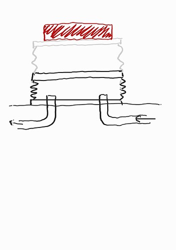

I'm building an Arduino controlled busker organ. The organ needs a reservoire of air with constant pressure. I'm reusing lots of old stuff. I have a pump for inflating small boats, which should be effective enough. But the air flow from the pump is not constant. And the air consumption of the organ is not constant. Therefore I have this design:
I use a bellows from an accordeon. I pump air into it. I let air go out to the pipes (the air goes to a wind chest, a chamber where the foot of the pipes comes through the ceiling. Each pipe end has its own servo valve.)
This bellows should have a constant pressure. Unfortunately the bellows acts as a spring. You need a bit force to extend the bellows, and there's a recognisable spring constant. That means that without a weigh on the top, the bellows would still produce a pressure, the higher the bellows extends, the higher pressure. My hope is that with a counteracting spring I could minimize the spring effect. I'd place a spring inside the bellows. Without a weigh on the top, the bellows would find an equilibrium. Extending the bellows from that equilibrium would need some force, pressing down the bellows would likewise need some force. After that, when I place a weight on top of everything (the red brick in the picture), I could add the pressure I need for the pipes to sound correct. The added pressure would be constant. But the spring effect of the bellows and the added counterspring would still be there. When pumping air into the bellows untill it reaches the no weigh equilibrium point would mean the bellows teoretically contains the pressure of the added weight. Pumping further would increase the pressure, using air and having the bellows go below the point will decrease the pressure. My aim is to minimize the difference. For the bellows to be of any use, I want the added weight to be the major part of the produced pressure and the spring effect to be as small as possible. And my big question is (besides is there any other flaws in my thinking) will the counterspring help at all? The spring effect of the accordeon bellows really is remarkable (I might be able to do something to it, it's from an 80 year old trashed accordeon), it extends some 30 cm until the force is way too big, and the equilibrium is just som 3 cm before fully pressed. My hope is that if I use a counterspring and get the equilibrium at say 15 cm, I could have a range from 10 cm to 20 cm, where the bellows would provide a pressure suitable for the pipes. The magnitude of the pressure would be determined by the weight and the variation in pressure between 10 cm and 30 cm would be as small as possible relative to the total mean pressure. My intuition says that the counterspring would minimize the ratio of variation / mean pressure. Am I wrong?

Why don't you use an air tank with a pressure regulator?
Or use the air pressure tank from a water well system. I see then advertised on Craigs list, sometimes for free. Most are still usable, but have been replaced as a precaution. Some have steel tanks, some fiberglass, but ALL have a rubber air bladder.

There are a ton of ways to do what you want depending on budget and the look you are going for. I have some experience in this area and am guessing you want something unique and cheap. The counteracting spring is a good idea except that the bellows is probably a progressive spring and that might be hard to do. Something utilizing the concept of the old Nautalis gym equipment could work. Let me know if you want some more info. It would be mechanical, self regulating, easy, and cheap.
On approach to obtaining roughly constant pressure is to run the pump at maximum capacity, but use a valve to bleed off excess pressure.
That won't work well if the demand is variable.

The bellows is working as a spring. I try my best to soften it, by stretching to extreme and maybe infusing with some leather softener, as long as there are leather parts that can be softened.
I have no idea yet. I need to adjust the pipes to get the best sound. If the pressure is too low, I can add weight on the bellows or I can widen the opening at the pipe foot. I could measure the air pressure and find out flow rates etc, but that would add a lot of complexity to the project. It's a shortcut to just build everything and then adjusting the pipes to what I have. But before that, I need to learn more about springs.

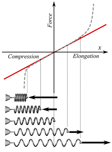

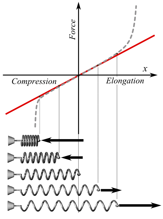

However a spring internal to the bellows may not be suitable, as it would be working over too wide a range of movement. (see fig)
You may need to consider a pulley and clock spring mechanism to suit the range of movement.

If you look at the sketch of your bellows there are some pressure and height numbers that I guessed at. Lets say that 1 psi of air will extend the bellows half way. But the pressure needs to increase to 8psi to get full extension. In the little graph of psi (vert axis) to extension, you can see that I think the force to extend the bellows will increase exponentially. That indicates a progressive spring. A normal linear spring would show a straight line in the graph. Finding a progressive spring to fit inside your bellows to give a neutral resistance throughout the entire travel might not be possible, plus there would be a bucking problem because of the length.
Instead, I propose a wooden wheel whose diameter is about 2 times the travel of the bellows travel. The wheel is fixed above the bellows with a rope attached to, and wrapped around, the wheel. The other end of the rope is attached to the top of the bellows. The wheel should be sized so that as the wheel is rotated thru approximately 1/5 rotation (72 degrees) the rope will pull the bellows through its full range of travel. There is a stick with a weight on the end of it attached to the wheel such that when the bellows is all the way closed, the stick is maybe 15 degrees past vertical. If you push down on the stick so that the rope pulls the bellows up, the effective radius of the weight increases, giving the weight more leverage so that it pulls harder and harder on the bellows.
You will need to experiment with wheel diameter, stick length and angle,and weight, to get a smooth extension of the bellows. When correctly balanced, just pushing on the stick with your finger should easily extend the bellows.
Then as you said, putting a brick or weight on the top of the bellows will establish the actual operating air pressure.

That's a very good idea, lloyd-ss! I will treat the bellows to lessen the spring effect (heat, oil, stretching), and if I can't achieve a setup with an even sound from the pipes through the whole bellows travel, I will definitely try this method. The wheel could be just a quadrant. It could be elliptical or whatever strange spiral, as long as its pull would at each point be equal to the spring force of the bellows.
