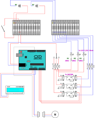

Here is a wiring diagram of our project. I know I could get problems with the power supply. I'm not a electrical technician so any improvements are welcome.
The inputs voltage is devided by 9V battery regulated by a LM2596 buck converter.
What sort of 9V battery, are you aware of the current that a servo draws when it moves or needs to hold position against a torque?
Tom... :slight_smile:

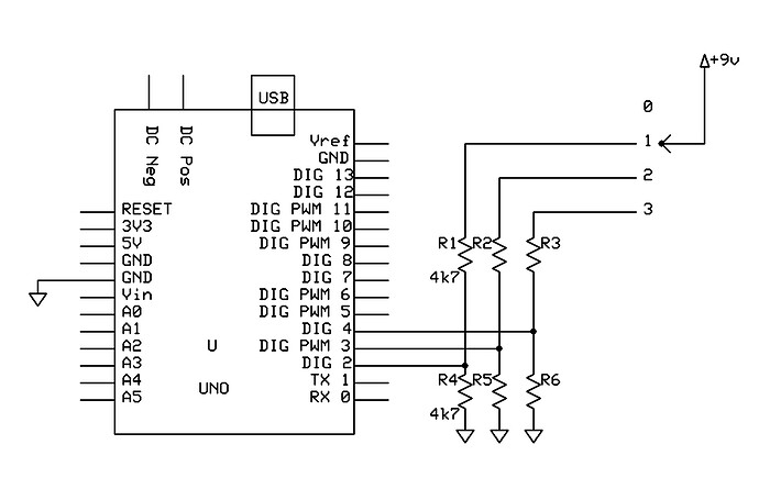

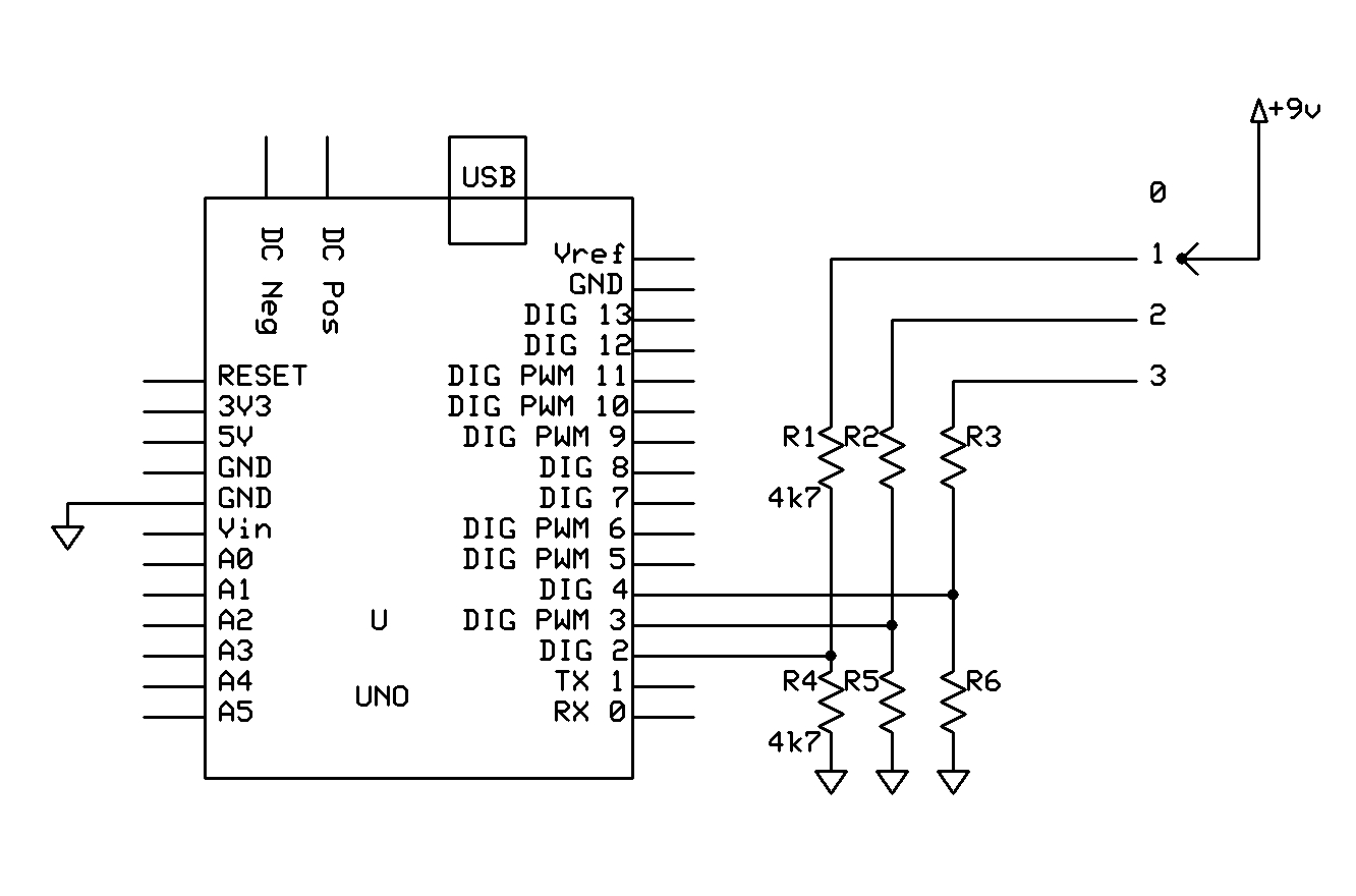

Hi, OPs circuit.
Do you have a position 0 for the switch, so 0,1,2,3.
What voltage are they switching, if 9V, you can use a voltage divider to rescale it to 5V for your three inputs and use digital mode.

Ok, I see what you are doing. The question, now, is what is the state of the LM2596 output when it not powered. It may be floating and also when the regulator is turned off, if there is nowhere for the stored power to go the output will stay high (analog inputs are very high resistance > 10M). The solution, i think, is pull down resistors on the regulator outputs (and therefore analog inputs) to ground to bleed the power and pull the analog inputs low. I suggest 10K (or higher if they don't affect operation).
If the voltage from the switch is known, those regulators could be replaced with resistor voltage dividers.
The output from the switch is either 0V or one (and only one) of 3 contacts (to A0, A1, A2 through the regulators) is closed. Is that right?
If so, analog inputs are not really needed. The analog input pins default to digital input on reset so you don't have to use pinMode to set them (doesn't hurt though).

Did you make your potential dividers like this?
