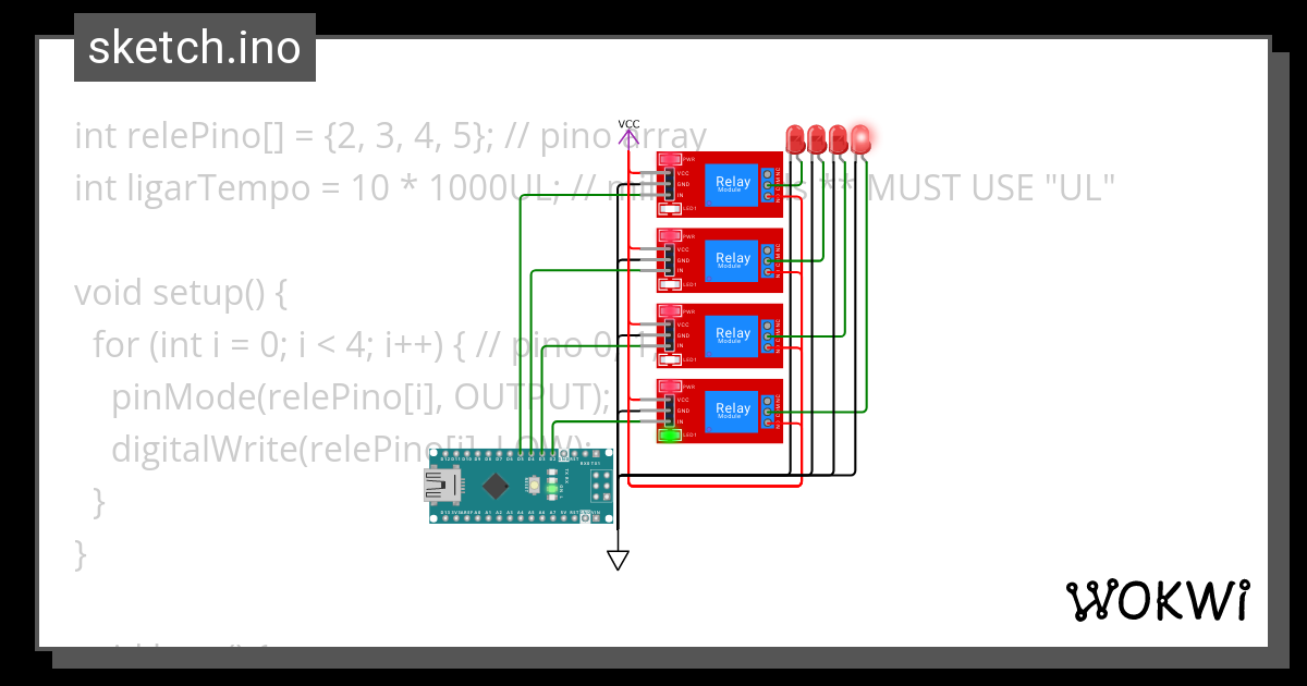

I understood the code line. Set each relay to be active for 10s. That would be more or less what I needed. I'll try to explain better.
The machine we are trying to automate is a pin drill. It has 3 pistons activated via electrical pulse and has a motor.
The first relay needed to be active for 30s. After that he hung up. and the 2nd relay activated for 10s (time for the piston to work) then the 3rd relay would also activate 10s and the 4th same time. After this loop returns to 1 with its time.

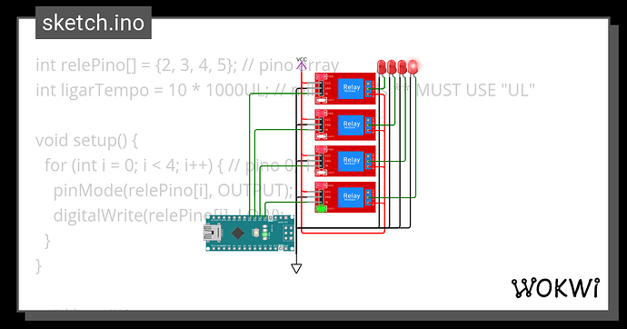

You can practice using this simulator...
