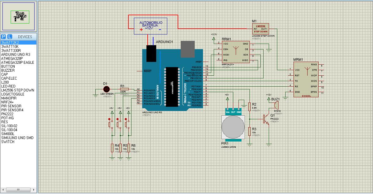

I am creating alarm system with wireless remote control.
I am using: 2 x nrf24l01, arduino uno, SIM800L and atmega328p.
I attached photos of circuits diagrams and program. I wrote a small program for GSM module(SIM800L).

Now I need help with bidirectional wireless control. There must be: 3buttons, vibromotor, blinking LED and atmega328p. It must turn on/off and reset alarm system. I do not know how to write program for this...

While functions are a great idea, this is silly. If there is only one thing for loop() to do, just have it do it.
    while(sistemos_veikimas=1)// kol sistema yra ijungta
Why are you assigning the value 1 to sistemos_veikimas in a while statement?
  if(digitalRead(valdymo_busena_off==HIGH))// tikrina ar isjunge sistema
Why does the relationship between valdymo_busena_off and HIGH define whether to read from pin 0 or pin 1?
Why would you be reading from the hardware serial pins?
I gave up reading your code at that point.
For which end? What are the requirements?
it must be
if(digitalRead(valdymo_busena_off==1))// tikrina ar isjunge sistema
Why I cant assing the value 1 to sistemos_veikimas in a while statement? In proteus its working.
It must be:
If(sistemos_veikimas==1

sorry for bad my english
Is one of these ')' in the wrong place?
I suspect so.
You can, but it doesn't make any sense to.
It DOES make sense to COMPARE the value in sistemos_veikimas to 1, but that is done using ==, not =.
That donkey crap software's behavior has NO bearing on reality.
PaulS:
I do wish you'd come down off the fence, stop beating about the bush and prevaricating, and simply just say what you really mean. :smiley:
it must be
? sorry I am beginner.
it must be
NO! NO! NO!
It MUST be
   while(sistemos_veikimas == 1)
OOOK!

Why I get this error "SMS_ijungta" was not declared in this scope
Again, ')' in wrong place?
AWOL:
Why ")" in wrong place?
I use this example Arduino Burglar Alarm using PIR Sensor with SMS Alarm
And you're certain the example is correct?
Think about it: the expression "valdymo_busena_off==HIGH" can have one of two values: zero or one.
So you're going to do a digitalRead on one of the serial I/O pins.
I dont know. Maybe this example is not correct. I dont have enough time to do this project. I am a student and I have to complete it quickly. I really need HELP...
if I connected it to analog pins, it will be like
priekiniu_busena=analogRead(priekiniu_mygtukas);
  if(analogRead(priekiniu_busena==1))// tikrina ar atidarytos priekines dureles
? and
analogWrite(LED,HIGH);
      delay(100);
      analogWrite(LED,LOW);
      delay(100);
Yes??
Reading analogue input pin zero or one makes a little more sense, but I still don't think you're on the right track.
Don't you think it's meant to be something simple like
  priekiniu_busena=digitalRead(priekiniu_mygtukas);
  if(priekiniu_busena==HIGH)
(Sorry, I don't know any Lithuanian, so "priekiniu_busena" is meaningless to me)
