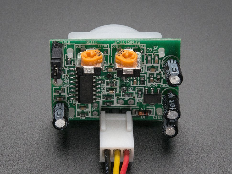

Hi all,
I'm having trouble with my PIR motion sensor:
I set the sensitivity to 25%
It keeps giving false positives. To test what the issue might be I put the sensor into a cardboard box and wrote a test program (see code below).
This is the circuit:
In the table below 30 random false positives are recorded with the time in seconds.
Also the time between show they occur randomly
What could be the problem here ? If it is unreliable I will have to look for an alternative sensor to detect motion. I was thinking about an ultrasonic range detector.
Or does anyone have a better suggestion ?

The program I used to test the PIR:
#include <StopWatch.h>
//SETUP COMPONENTS ==========================================
//PIR sensor
#define pinPir 2    //PIR sensor output
////piezo buzzer
#define pinPiezo 3
// Status leds
#define ledGreen 4
#define ledRed 5
//PIR SENSOR VARS ===================================================
//the time we give the sensor to calibrate (30-60 secs for ADA-189)
int calibrationTime = 45;
StopWatch stwTrack(StopWatch::SECONDS);
//SETUP
  //setup pir sensor
  pinMode(pinPir, INPUT);
  digitalWrite(pinPir, LOW);
  //setup leds
  pinMode(ledRed, OUTPUT);
  digitalWrite(ledRed, LOW);
  //give the sensor some time to calibrate
  Serial.println("calibrating sensor ");
  for (int i = 0; i < calibrationTime; i++) {
    Serial.println(calibrationTime - i);
  Serial.println(" done");
  Serial.println("SENSOR ACTIVE");
  delay(50);
// MAIN LOOP
      //if the stopwatch is not running, start it
      if(stwTrack.isRunning() == 0){
        stwTrack.start();
      //check the PIR input
      if (digitalRead(pinPir) == HIGH) {
        tone(pinPiezo, 1000);
        noTone(pinPiezo);
        digitalWrite(ledRed, HIGH);
        Serial.println(stwTrack.elapsed());   //print the time
        delay(7000);                          //wait for the PIR to go low
