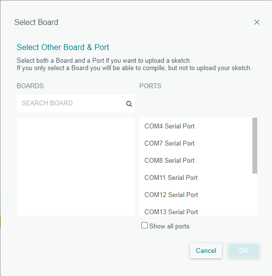

All board and Library are lost
I use Arduino IDE 2.0.0-rc8
As you can see, i don't have any library . . .
Board selection
Boards manager
Library manager

I fail at the point 5.
So i uninstall Arduino 1.8.19 and Arduino IDE 2.0.0-rc8 and also i delected all arduino in C:/ and AppdData.
After reinstallation, i have that in my bordel selector :
Also an empty borads and lbrary manager
But after few minutes :
I think there was a conflict with the old files of the old version with the new
The installation took about 45 minutes;
thank you for your time, I'll let you close the topic unless you have other questions for me?

The reason for this is the Arduino IDE must download some data from the Internet before it can populate these. Arduino IDE 1.x was designed so that you had to wait for the downloads to finish before you could even start using the Library Manager and Boards Manager dialogs, but Arduino IDE 2.x does not, which can be quite confusing at times. There is actually work in progress now to communicate to the user that the downloads are in progress:
(it is being done as part of a fix for separate bug)
