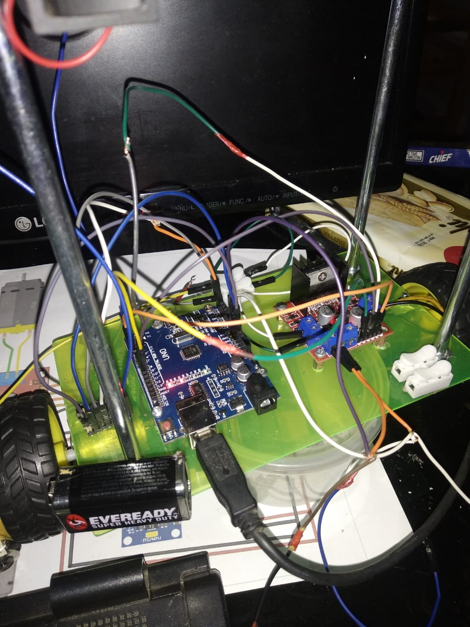

Hi, I'm a newbie in Arduino and have searched the issue in this web but I didn't find any related to my problem (or, I missed one).
All is okay means that I assemble self balancing robot based on this following diagram and has plug all and serial monitor shows that it works. But WHEELS not rotating at all.
(This time, I plugin power from my old notebook).
Don’t see any wires to the PWM pins. (enable A and B)
What is the battery voltage ?
sorry, late to answer. really glad. owh yes. 9 volt. Beside that I open the jumper (enA and enB). When I close the jumpers. The red led turn off.
From the code I see that it only enables 4 pinoutsL 11,10,9,6 ( based on the circuit diagram above)

What is your 9V supply, hopefully not a PP3 smokedetector battery, that will not have the power you need.
Can you please post your code? (Using code tags)
To add code please click this link;
Can you post an image(s) of your project so we can see your component layout?
Do you have a DMM?

NB: I use 9v Eveready :slight_smile: (Should I use 18650 battery?)
It should work when the robot connected to the notebook, but It shows nothing ... DMP works successfully and Serial Monitor (COM4) gives me clear how MPU6050 reacts when I tilt the robot but wheels never turn at all.
Here's what com4 says to me:
Here's how my project looks like :slight_smile:
Try adding enable A and B PWM CONTROL.
Ehm ... The wheels .... turns hihihi .. thanks. SOLVED.
But, please, explain me why should enable them both since there's no instruction in that code. I see no command to enable it. Thanks
