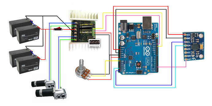

I am creating a Segway with arduino uno (original one).
The arduino gets power supply throw the 5v dc output in Sabertooth25X2 (the motor controller). The Sabertooth get power from 4 Lead-acid batterys (total: 24V, 18ah)
The arduino connected to MPU6050 and pass data to Sabertooth for operating the motor (Wheelchair motors)

I am attaching the connections that I did (one note - In one of the boards I connected the V+ from sabertooth to 5V pin, and on the next try I connected it to the Vin pin)

If you provide 5V to the Arduino, use the 5V pin, not the Vin.
But what's powered from the Arduino? Is it just controlling some drivers? En is the 5V from the Sabertooth stable? No weird spikes?
Are you sure that the Sabertooth's 5V output is truly giving 5V? It sounds like you've possibly applied more than 5V to the Arduino's 5V pins and fried something.
Measured by AVOMeter and it was exactly 5V.
noamnri:
Well that's a good thing at least.
