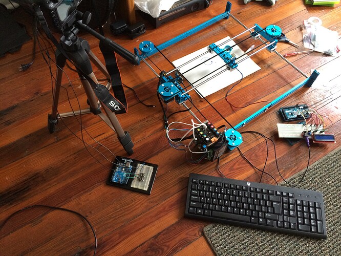

In case anyone's interested, I've attached a picture of the pieces of the whole project rounded up together. I'm trying to build a system where someone could type in a word, and the system would draw out the word with an LED while capturing it with a DSLR. I've still got a ways to go, as I'm sure you can tell!
