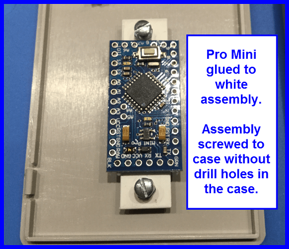

Never use ‘exposed’ screws on your project cases.
Use epoxy to join components to the inside walls of the metal chassis.
Even double stick foam tape works great to secure things to inside walls.
You can epoxy brackets to the inside walls then components are screwed to those brackets.
If you line the inside walls with plastic sheeting, you can then add items to that sheeting with screws, threaded standoffs etc.
You can also epoxy FR4 PCB copper clad material to the inside walls; you will have inside walls that you can solder support brackets to etc.
