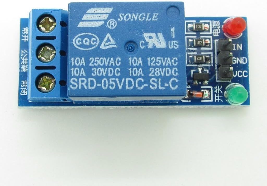

  1. Should I use a 12v relay instead?, I read around and found something that says I can make arduino nano digital pin to send a 12v to trigger the relay using 2n2222 transistor or something. Since from what I asked around the 12v relay need more than 5v to trigger.

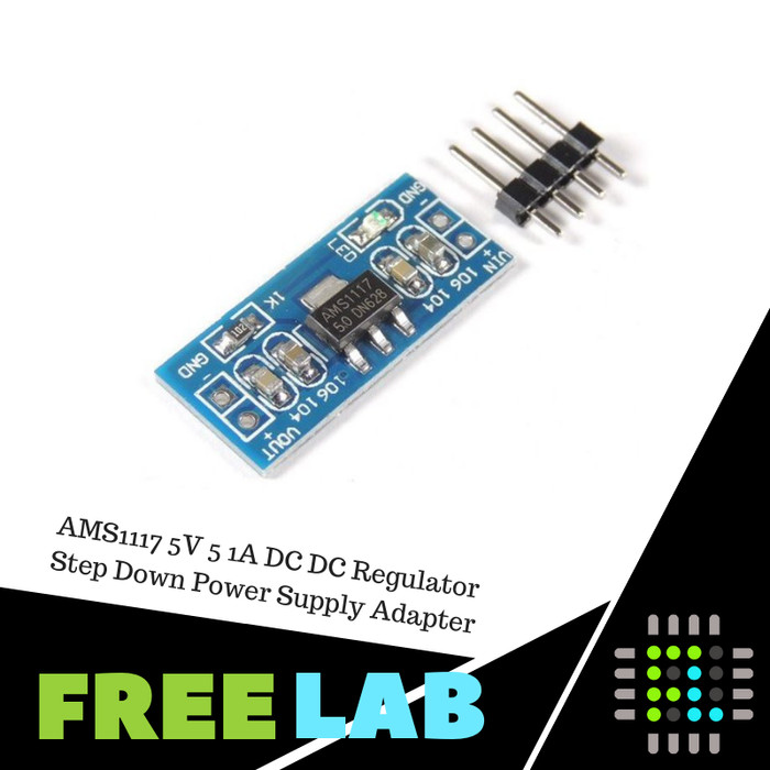

  2. Is there a way to reduce the 12v to 5v without using a regulator module? if so, can someone teach me how?. Since I prefer to keep the size of the box as small as possible.

Using a 12V relay seems to be complicating stuff. A 5v relay should work just fine.
Also, the Arduino nano has a 5V regulator built in - it should be able to take you 12V in on the Vin pin.

Well that's what I thought too, just wondering wether it makes the 5v relay breaks waay too soon.
Nah, that's not right. The 5V in 5 volt relay refers to the trigger voltage. a 12 volt relay isn't necessarily going to last longer. The picture you're showing here for your relay is rated for 10A - you should be fine if you're under that.
binaryfissiongames:
Yeah should be under 10A, it's just around 2-4A for the 200cm led strip.
