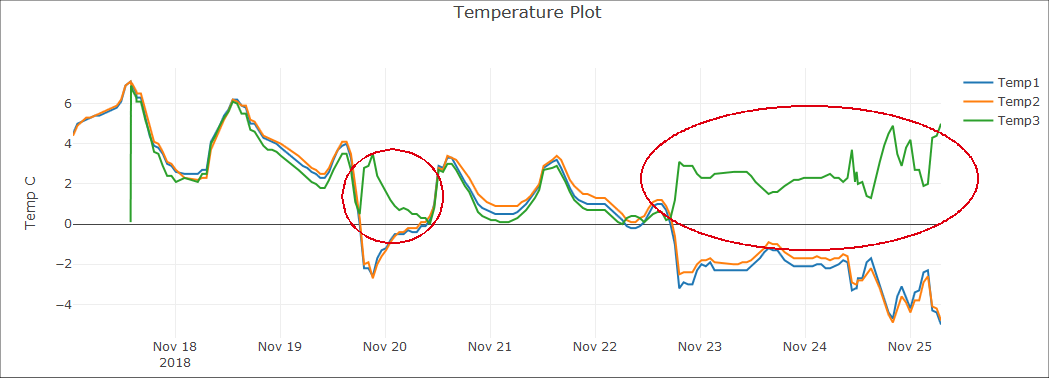

I attach the temperature plot made where I saw the sign reversal of sensor Temp3.
Check the two circled areas where the green trace is mirrored on the X axis...
Today I have moved sensors around and it seems like there is some kind of problem with the wiring towards the sensor location #3. When I move the sensor from position 3 and connect it directly to the central unit it behaves sensibly and another sensor moved to location #3 shows strange values, for example positive even though the temp is negative.
Or humidity at 99.9% or so....
Right now sensor #3 reports +4.4C and 82.4% even though the sensors #1 and #2 show temp -3.9 and -3.1C respectively.

Right now I have recorded 8 hourly readings since I replaced the sensor #3
"Statistics":
  • missing
    +3.9
  • missing
    +6.0
  • missing
    -7.3
    -7.8
    -8.2
    So the last 3 readings are OK, 5 are either NAN or positive.
    Could it be that when noise hits the transmission there is a 40% chance of it getting passed as a positive value and 60% chance it gets trapped by the checksum? Or is there a higher chance of errors if the value to read is negative?

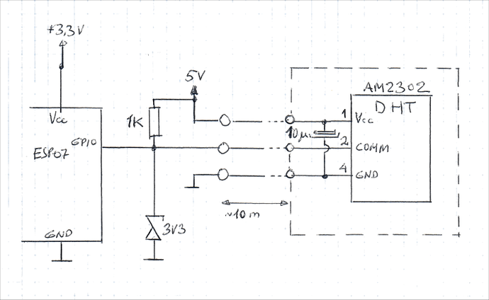

OOPS! I found this in the data sheet:
4.2 Power supply pins(VDD GND)
AM2302 supply voltage range 3.3V - 5.5V, recommended supply voltage is 5V.
7.1 Special instructions of the single-bus communication:
1.Typical application circuit recommended in the short cable length of 30 meters on the 5.1K
pull-up resistor pullup resistor according to the actual situation of lower than 30 m.
2.With 3.3V supply voltage, cable length shall not be greater than 100cm. Otherwise, the line
voltage drop will lead to the sensor power supply, resulting in measurement error.
So I have rebuilt the electronics today to feed 5V to the sensors while keeping 3.3V for the ESP-07.
Will show a simplified diagram tomorrow if it pans out OK (too dark to do anything today).
I have tested the new design indoors by connecting a sensor using a reel of the remaining 25 m of signal cable I have available. So this is more than twice the cable length I used in the attic and the sensor is one of the ones I tested yesterday and it failed. Now it does not fail anymore but produces good readings all the time.
So I made a quick drawing and scanned it to show here.
What I did was this:
  1. I connected a 5V linear regulator on the incoming 12V to get me the sensor supply.
  2. I connected 1K pull-up resistors from the 4 outputs used to read the sensors to the +5V line
    (1K because the zener would not go higher than about 2.7V with 10K)
  3. I also connected 3.3V zener diodes from the outputs to ground to limit signal swing to 3V
  4. I wired the +5V supply to the 4 sensor's connector power lines (was 3.3V earlier)
    On the sensor side I did not change anything, I kept the higher resistance pull-ups as they were
Here is the schematic of this:
I think this will have solved the problem, test tomorrow morning.
UPDATE:
With the change to using a 5V supply for the sensors (see schematic above) the readings are now all OK!
:slight_smile:
