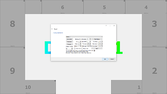

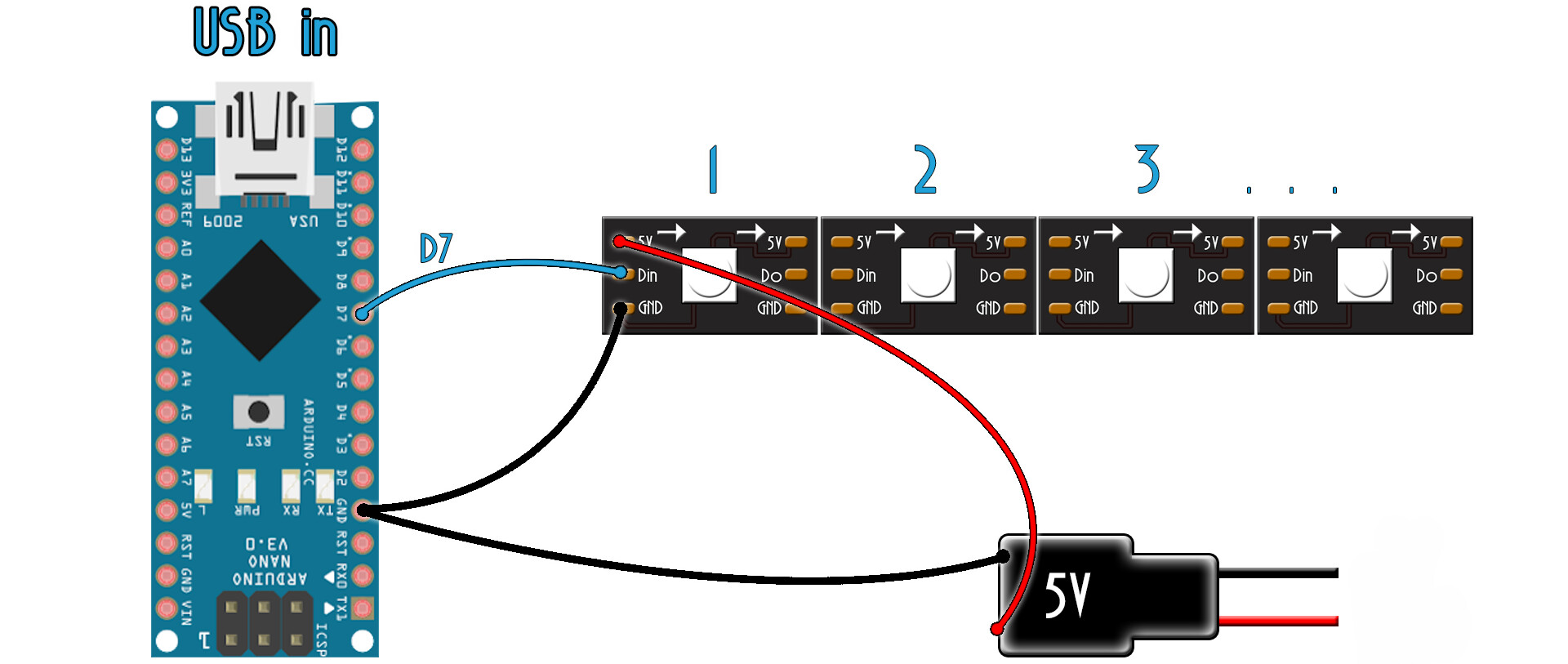

Hello, I have an ambilight project set up with an arduino nano as in the picture. The connection is as in the diagram, there is only an on-off switch on the + end coming from the power supply. My code and arduino work without any problems. There is no problem with soldering either, but there is a situation like this. When I first turn on the switch, all 104 of my 104 leds are white lighting. When I turn on the computer, when I open the prismatic application, I turn on the led red, but half of the led is red and the other half goes off. When I change the colors, only half of it changes color, while the other half stays off. My power supply is 5 V 5 A, what do you think the problem could be, can you help me with this?
you should set in software on PC how much LED it should use
I already set the led count there.

Use a new LED strip, and connect it with the recommended parts.
That is: a 330 ohm resistor in the Din line, close to the first LED, and a 1000uF capacitor between 5volt and ground, close to the LED strip.
Failing to use those parts could destroy the strip under certain circumstances.
Leo..

as i said, check connection between that piece that lights and that that not light. probably you destroy solder pad. can you show photos ?
If you use the plastic three-pin connectors to make turns, those plastic connectors are not very strong. A few failed for me, so I just soldered the rest.
Or, you have the "not on" section backwards. DOUT should go to DIN.
Because initially all 104 lights were bright white, I suspect that the LED strip is not damaged. You can try connecting the wire to the non-bright LED chip and see if the latter half of the LED strip can be controlled normally. If it can, it means that the LED strip is not the problem, but the problem is with the program that causes the latter half of the LED strip not to light up. If the latter half still does not light up after changing the wiring, it may be that the LED chip is damaged. You can cut off the damaged LED chip and test again. I am the original company of WS2812, if you have any other questions, please feel free to contact me.
