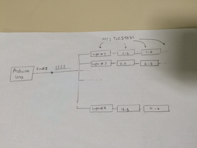

Hello,
Currently I have an Arduino Uno outputting 0-5V pulse signals to program my lighting devices via a TI protocol call Single-Wire communication. Since there are so many lighting devices that need to read that same signal from the same output of the Arduino and those lights are like 50ft away from my Arduino Uno, my pulse signal drops so low (0-1V) that my lighting devices couldn't understand the signal.
I would think I need some sort of signal buffer/signal repeater to help solving the issue. Since the Arduino can only output 50mA max, I am hoping to raise its ability to 400mA or more while maintaining its good frequency (600kps data transfer rate).
Wondering if my thought is correct and if someone experience this same issue before, and how they solve it. Any recommendation on what buffer/repeater/shield would be deeply appreciated.

If I follow the data sheets correctly, the Arduino only has to supply the PWM signal to the first TI device. After that the TI devices are all daisy-chained together. Is this how your circuit is connected? Or are you trying to drive each TI device individually? The data sheet says there is no limit to how many devices can be chained together.

Hi Paul:
You're absolutely correct, I only send the data to my first 16 lights devices on 16 different strings (all in parallel and connected into the single output from my Arduino). The rest will just be daisy chained together as you said. You can take a look at my quick draw for a reference. There's no limit of how many lights can be chained.
Each first devices of on those 16 strings are located about 50Ft away from my Arduino. I use 22AWG 2 conductors cable with shield to transmit my data.
If the Arduino connects to only 1 string, my pulse signal from Arduino is good (5V pulse signal). But when I hook up the other 15 strings, the pulse signal from the Arduino drops down to ~1V pulse signal, which is too low for the TI Driver to decode, I believe. My thought is because I have long cable, heavy load, and the Arduino doesn't have enough current/voltage to drive the data signal into my first 16 light devices on the 16 strings.
Ok. I do see, now. Probably if you hook up only 2 strings, it still works fine, but added individually, at some point doesn't work. You need to add a driver IC between the Arduino pin and the strings. I will let one of the electronic engineers tell you some device numbers. But a single or perhaps two devices will solve your problem and they will all run off 5 volts.

That depends. I am guessing your TI devices are not real close to your Arduino. They are connected by wires. So, regular quad buffers won't work. All the wires need to be the same length and need to be twisted pairs.
I have not thought about this kind of stuff since the 1970's, so I am a bit out of date, but I think we need to look at "line drivers". They are designed to send digital signals for some distances over twisted pair wires.
