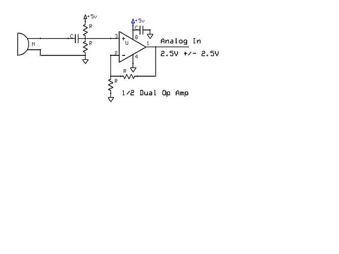

i researched google quite a bit to get something to amplify the signals of a mic.
i have been thinking, what is the problem of using an op amp?
wont that work?
Op amp would be fine.

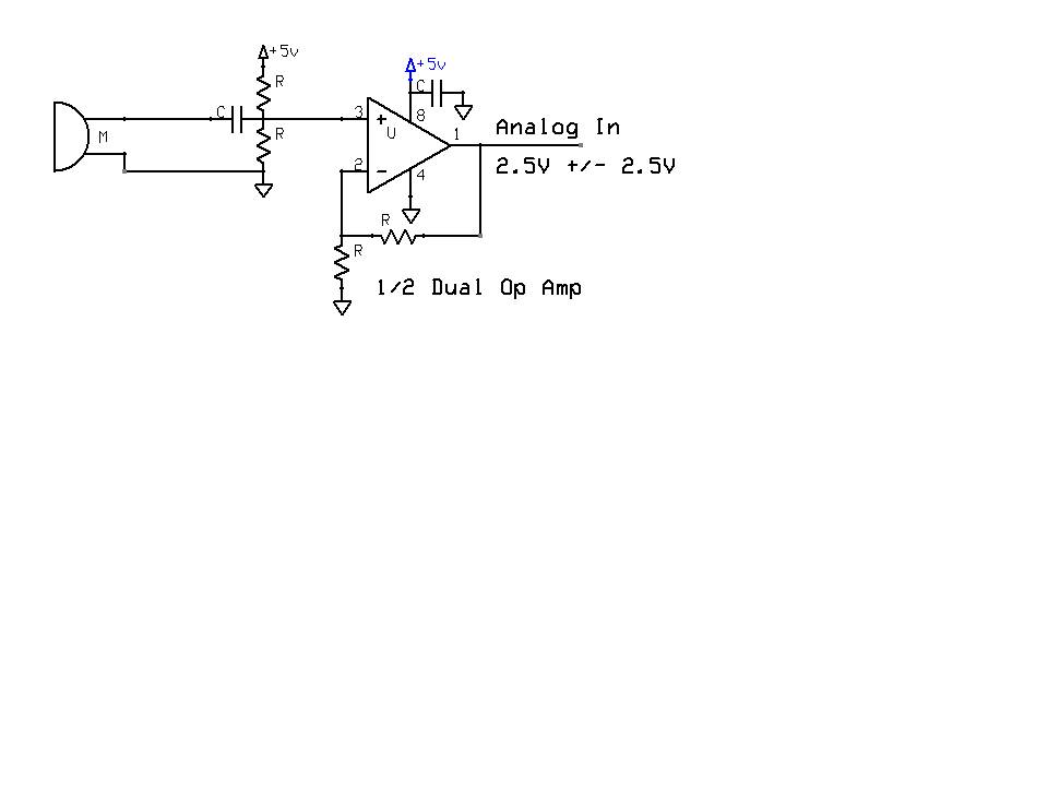

Use one that will work with a 0/5V supply, bring your mic in thru a capacitor to an input pin; use 2 10K resistors to have the pin sit at 2.5V.

Don't get greedy, it is such a simple circuit it will do you good to lay it out yourself.
No you can't get that much gain out of a single transistor.

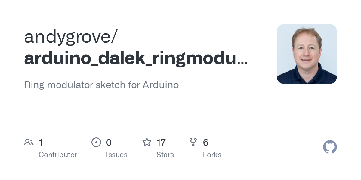

Or even better here is a breakout board with a Mic and a built-in amplifier for $8:
I used the latter successfully in an Arduino project that took Mic input, applied a ring modulator effect, and then played the output on a speaker. Here is a link with circuit diagrams and code:
Hope that helps.
