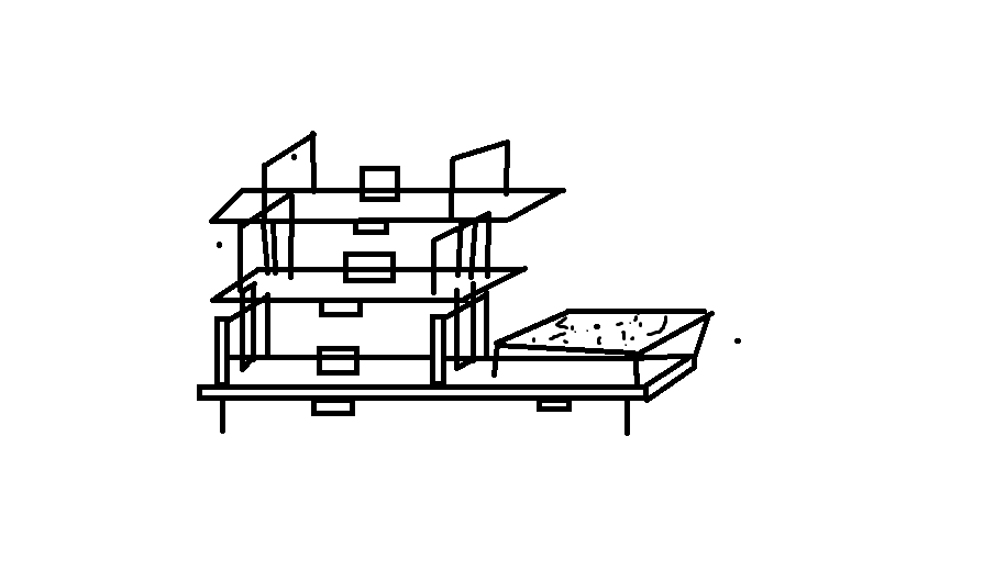

Meh... well my spring break comes to an end :[. Freakin' depressing lol, but here is the general schematic for the base unit. I tried to put it into an easier format for better understanding. (This is the unit everything else connects to when in considering it as a standalone network.)
This is top view that should help explain what I mean about connectivity. I have also decided to add a flat ultra bright LED of the bottom of the board between pin D0 which will have a switch for on/off. Cheers :smiley:
So . . . Stacking this many boards is freaking complicated while trying to avoid wires. How do you transfer 5v's to 5 shields stacked up on top of one and another while keeping a low center of weight distribution? Its going to be one unit so it needs to e stable. Cables anywhere past the 2nd level will make it wonky.
So all the power is on level 1, and you can use jumper cables to reach the other boards. (The expansions will have screw terminals to secure the power flow.) There will be 2 12v AC PSU's on the base as well, giving you a max of 4 levels in total. Hopefully that will suffice.

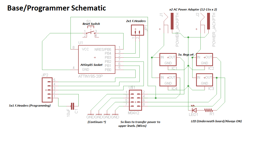

So here is the schematic for the base unit (The I/O's will change :P).

Need your feedback on this. Being the expansions (higher level boards) are half the diameter of the base board. There is a little space above the 5v Regs. Would you think a mini bread board is a nice feature here. I think it adds to the self contained idea as well as you could host sensors and whatnot over there. I don't know let me know what you think. (PS I'm not a Paint artist :P)
I have to cancel this project :{.
The routing between components is too complicated. It isn't flowing due to all the overlapping connections and regulators. It's probably possible, but I can't do it. The result versus the amount of work this is taking isn't worth it.
I still have like 20 Attiny85's though. I'm just going to make a bunch of them (singles.)

That is a good idea, but how would you manage the routing of x3 5v regulators on a single sided copper clad board though? That was the real issue.
What was the reason for multiplying the regulators? How many ATTinies was that to run?

Well, how many Attiny85's can I run on a single regulator without risking overheating it? Perhaps that is also an input question as well.
I choose 4 regs., for 4 micro processors because it was a safe assumption and guaranteed all would be "fed" properly. I want all Attiny's to have an output of 4+v.

dritchie0042:
Depends on the regulator but in general, lots. At 5V and 8MHz, an ATtiny85 only draws 5mA. At 16MHz, 9mA. LEDs or whatever other loads are connected might actually account for the majority of the current.
If each board had a small regulator, rated for maybe 100mA, then they could maybe be used little more independently. When stacked they could be fed with 7-12V. OTOH, I don't see a lot wrong with one larger regulator feeding the whole stack, and that would cost less. Depends on what you want to do.

Well, how many Attiny85’s can I run on a single regulator without risking overheating it? Perhaps that is also an input question as well.
I choose 4 regs., for 4 micro processors because it was a safe assumption and guaranteed all would be “fed” properly. I want all Attiny’s to have an output of 4+v.
The ATTiny85 has 200mA as the absolute maximum current across VCC & GND pins (section 21.1 of the datasheet) so if you’re using a basic LM7805 linear voltage regulator which can output 1.5A the answer is “at least 7”. In reality that is the absolute maximum consumption, which would be achieved when the output pins of the ATTiny are being used to source power (up to 40mA each) and wouldn’t be where the uCs are comfortable operating for long periods. As noted above, it would be preferable the LEDs are fed power directly and the ATTiny is used to control rather than power them.
I would expect one voltage regulator to have covered 4x ATTiny85 with lots of headroom. The question of heat is a factor of what voltage you’re regulating down from also. The higher the input voltage, the higher the power that is converted to heat by the linear regulator.

The ideal would have leds and other loads not draw their operating power through the MCU's at all. That's what resistor-transistor pairs or driver chips are for.
My UNO has a regulator that gets -bypassed- when operating on USB power. It is only there for when I want to run from higher voltage sources which so far has been never. My Teensies don't have regulators at all and they work just fine.
You best choice is to make the regulators part of the power system. 3 Tiny's on a socket certainly don't call for 3 regulators. 3 bypass caps maybe but not 3 regulators.
3 bypass caps maybe...
If you want analog-to-digital conversion to work there is no "maybe" about it. ATtiny processors really truly need physically close bypass capacitors.
