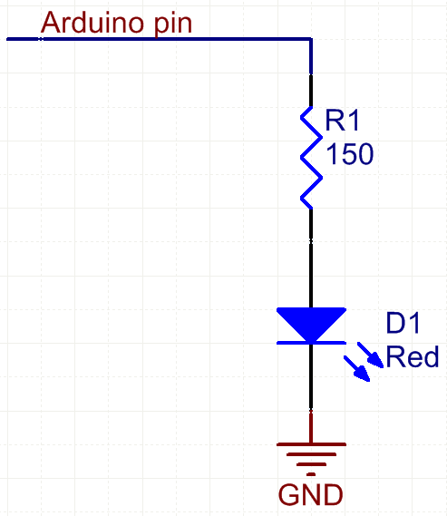

Lastly for now, along the same lines, the circuit I made earlier tonight has all LEDs hooked up to power with 2 resistors that go 680 ohm to 330 ohm to LED to ground. here is a picture:
For the blink fading effect I want, I thought I could send the signal from the arduino between the resistors and work: but when I power the Arduino, the LED goes dark and I have to set a minimum brightness (reflected in the code). Any other ideas for the circuit? should I stay with the idea of all the LEDs connected to ground, and sending a signal that will make individual ones brighter? or try something altogether different?

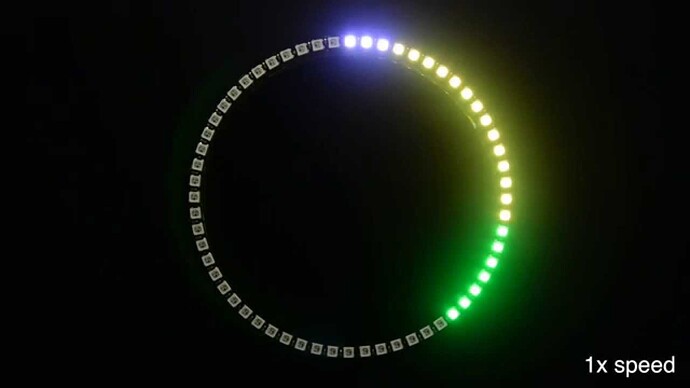

Look into WS2812B for the LEDs.
Well now that is a cool LED setup. Unfortunately the diameter is smaller than what I want, I'm looking at about double that. Otherwise it'd be perfect!

Forgot to say:
The way you have your LEDs hooked up looks a little strange to me.
You can source directly from your arduino pin. See attached.
To figure out your resistor value:
First find out your IO voltage, should be 5V for your board.
Next find the forward voltage for your LED (look in the datasheet), for Red it's usually ~2V.
Determine the current you want (determines brightness). For standard LEDs they usually test up to ~20mA, but for a system that will use as many LEDs as yours, you most likely want to dial that down to 5mA or less.
Use Ohms law and play with the values to determine the max brightness you want:
(supply voltage - LED forward voltage) / current = resistance
ex:
for 10mA, (5V - 2V) / .010 = 300 ohms
adhue587:
That was simply a way of giving the LEDs the "10%" minimum glow.

You want the NeoPixels (WS2812). You are just going to have to assemble them by hand or CAD a custom PCB to mount them. And of course, they are coloured.
