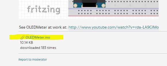

Fritzing diagram:
See OLEDMeter at work at: http://www.youtube.com/watch?v=rda-LA9GIMo
OLEDMeter.ino (10.1 KB)

The code is complete… you need to load the libraries to make this work. This is not a beginner animation and you should try some basic Arduino codes first. Arduino is a learning tool and I am not going to hold your hand.
~Stievenart
I HAVE ATTACHED THE WHOLE CODE A SECOND TIME BELOW!
