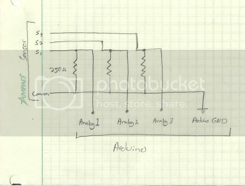

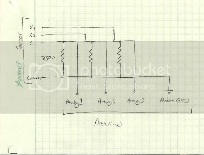

Here is the signal conditioner I will be using. It will be the thermocouple model, 115VAC input, 4-20 mA input.
http://www.omega.com/ppt/pptsc.asp?ref=DRF-TC
Here is the proposed circuit design. Hopefully that makes sense. I can put it in Multisim if that is helpful.
That's three sensors over three resistors.
That looks fine. The common of course will have to wire to each of the four COM terminals on the three devices, and each measurement wire, S1, S2, and S3 will wire to a "Iout" terminal on the devices.
Good luck.
Lefty
Excellent. Thanks for the help!
