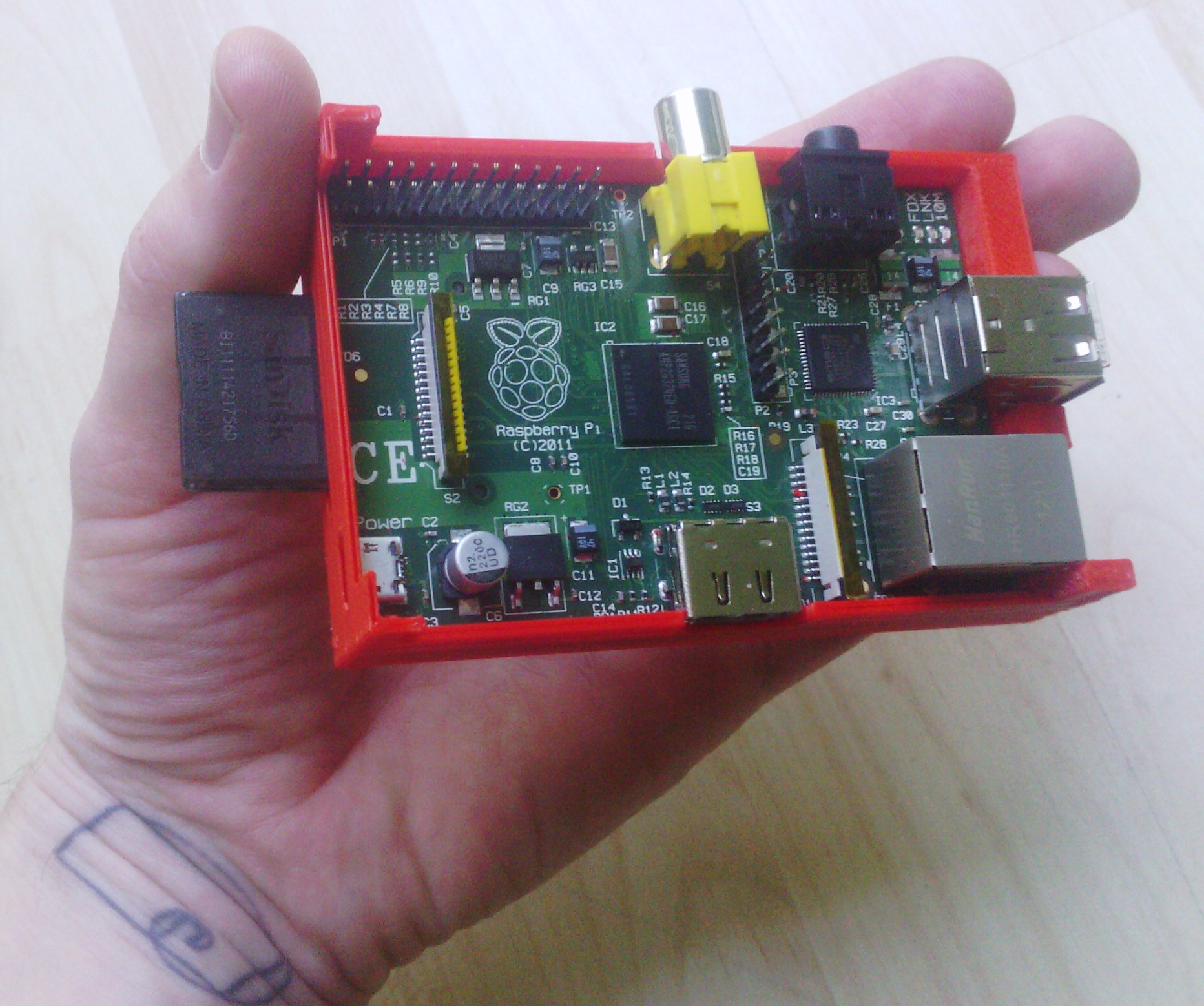

yea, and you have a better chance of seeing a leprechaun fighting a wizard than getting your hands on a pi anytime soon
this is my pi on my hand.
no leprechauns.
fkeel:
Yeah, but you'd probably find 10 people who claim to have seen a leprechaun (though maybe not one fighting a wizard) for every person who's actually held an RPi.
fkeel:
no leprechauns.
great, your one of the 10,000 lottery winners in a very limited section of the world, but just like the lottery, I wouldn't bank my life on it. They haven't even offered to sell it outside of its few select markets, and even in its few select markets there's a least a years worth of back-orders at the moment.

I was not one of the initial 10.000 - I just got it last week. And I am in mainland europe where they initially where not allowed to ship to, due to some legal reasons I do not understand.

No leprechauns here either.
I've got two, one in each hand :slight_smile: I ordered from both suppliers and was lucky enough to get one one from the original 10K and a second from the second batch.
