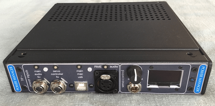

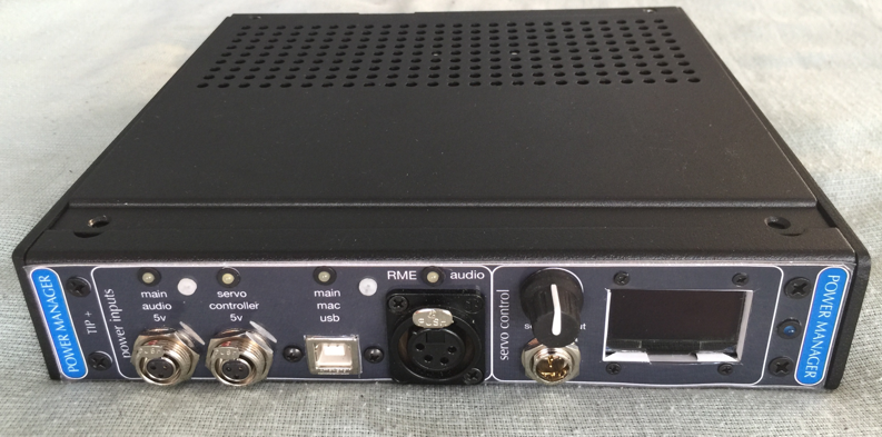

The specific goal here is simple: when a Mac is powered down (by a user), I want an audio interface to also power down. There’s a USB cable from the Mac to an Arduino pin (not the micro USB port), which acts as a sort of sensor, when the Macs turn off, the voltage drops on the USB cable’s +/- wires, the Arduino notices and drops a MOSFET gate’s voltage to LOW (0V) and the audio interfaces turn off. This works as expected in my studio with a Mac and a test device in place of the audio interface (details below), but when I bring the project into the orchestra pit at my show (the ultimate destination), something unexpected happens.

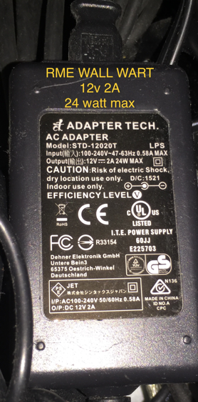

All devices are powered by DC Power Adapters (‘wall wart’ style), except for a MacMini which plugs into a UPS device, which is plugged into A/C.

The problem is as long as the Mac’s USB cable is plugged in, I seem to be unable to turn off the MOSFET. As mentioned, when the Mac is powered down, the Arduino attempts to set the pin controlling the MOSFET’s Gate to LOW (0V), but current seems to keep flowing from Drain to Source, and the connected audio interface remains powered ON. If I physically remove either end of the USB cable, the connected device immediately powers OFF. Plug the USB cable back in, device turns ON, pull it out, device turns OFF.
Can someone explain to me how a USB cable from a powered down MacMini is able to turn the MOSFET on and off?
Again, if I exchange the audio interface with the test device (equipment details below), the MOSFET behaves just fine - the device turns ON and OFF as expected. But when I re-instate the actual device, the audio interface, the MOSFET behaves as before, turning OFF only if the USB plug is physically removed.
I should note that the audio interface also runs a separate usb cable to the MacMini so maybe power is coming from there somehow? But these particular audio interfaces cannot run on usb power alone (RME Audio Interface Bus Power), plus the Mac is powered DOWN and shouldn’t be sending any power thru USB.
