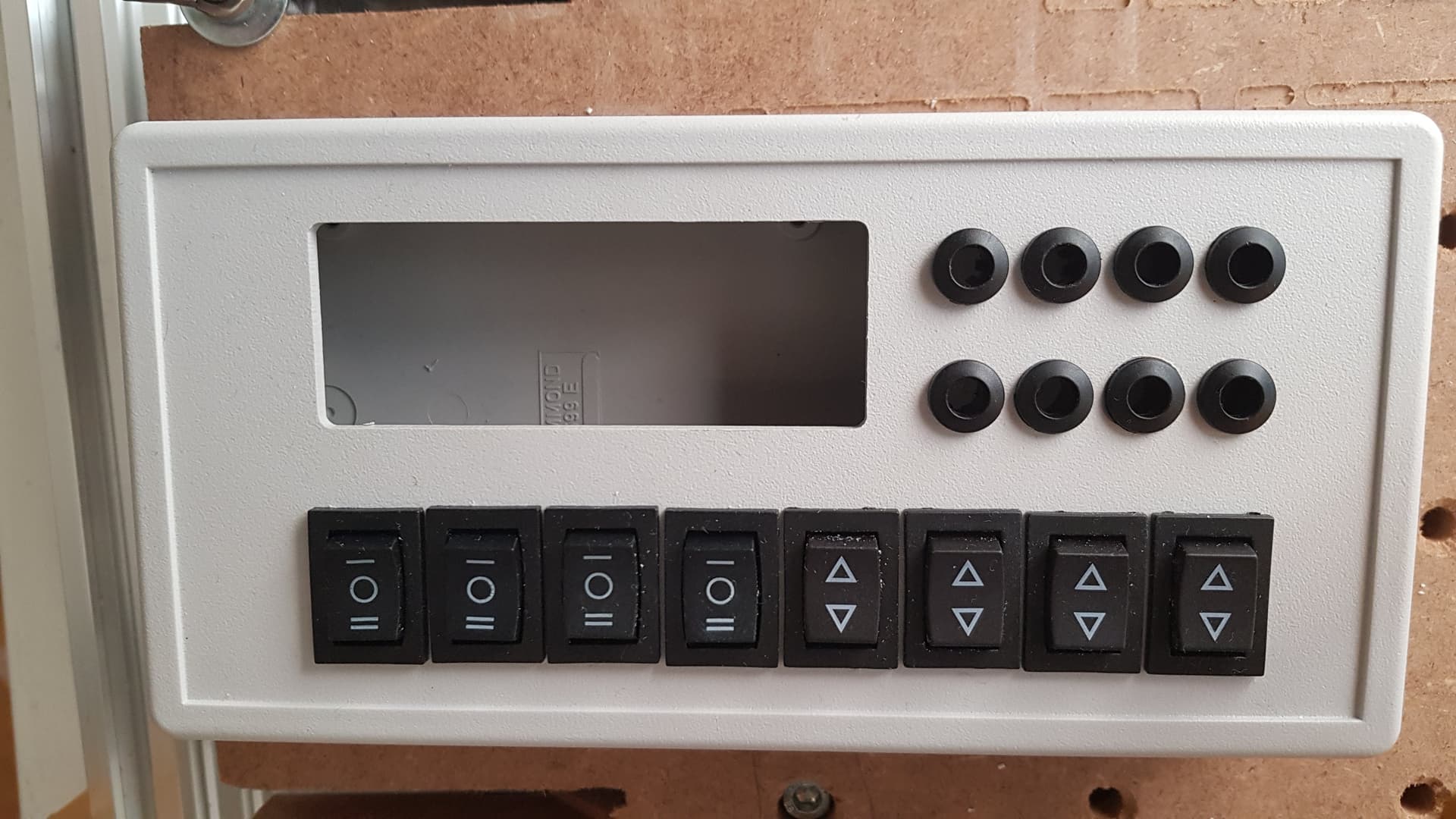

A CNC router can give you good cutouts \*)
 ![testbox20211029_112204m](https://europe1.discourse-cdn.com/arduino/original/4X/8/7/5/87583c1fec776b67de5aebb43cc4eb1d82300b3b.jpeg)
\*) after playing hours with the settings ...
