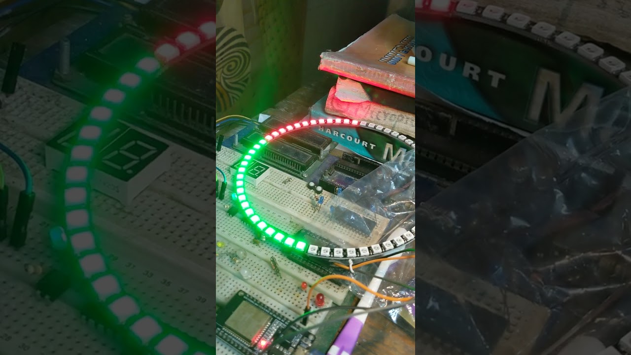

My Neopixel 32-LED array works fine with 3.3V Supply, DPin-13 of 30-pin ESP32 Dev Board. This is the sketch taken from IDE Examples:

Your sketch runs well in my 30-pin ESP32 Dev Board on DPin-2. The target LED is turned On called by LEDon(n).

I think my LEDs are W2812. Simple connection :
30-pin ESP32 LED
3.3V VCC
GND GND
13 DIN
