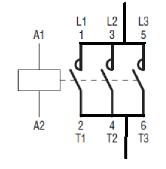

Ok I see this. We have this in market. But... I don't use 3 phase motor. It's a normal single phase 1hp pump (for 220v - 240v AC). Additionally I need to switch it using a relay (via esp32). I don't understand how contractor might help in this case ? Or am I wrong ?
Just use one leg.
Or parallel all three sets of contacts.
Make sure you get the correct coil voltage.
Ah i think I see what you are talking about. I just found this video and i think I can picture stuff better now.
