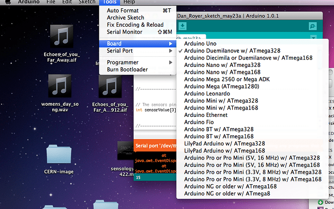

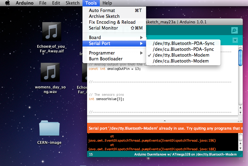

Hello Nick,
I am not sure what you mean -- I have attached some screen shots.
The choice in the Arduino program and the error message both use the same terminology /dev/tty.Bluetooth-Modem
I do not know how to find any other name.
Thank you for any further information.
Regards,
Victoria

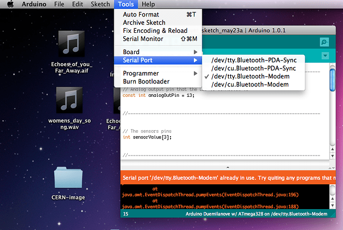

Those serial ports are exactly what I see with no Arduino plugged in. So it hasn't recognized it.

The problem seems to be that the computer isn't seeing the Arduino board at all.
Maybe try a different USB cable? Or if you've been going through a USB hub, trying plugging the board directly to the computer.

I think you need to re-install the FTDI drivers for Mac. USB will happily power up a device and enumerate it, but it cannot be treated as a serial port until the drivers are installed.
Also, try a different USB cable.
