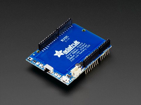

I'm trying to integrate a rechargeable battery. I was about to buy one of these solutions:
http://www.seeedstudio.com/depot/LiPo-Rider-Pro-p-992.html
In the meantime, I realized that the Intel Curie chip has a Battery charging circuitry (PMIC).
Can the Curie PMIC battery charging circuitry be used? Or should I just buy one of the third-party charging boards to integrate the battery?
I need to have a working prototype really soon so timing is a factor.
Thanks for your feedback.
Julien
Hi Julien,
unfortunately, even though the Curie chip contains a battery charger, its pins are not exported to any header so you can't use them directly
