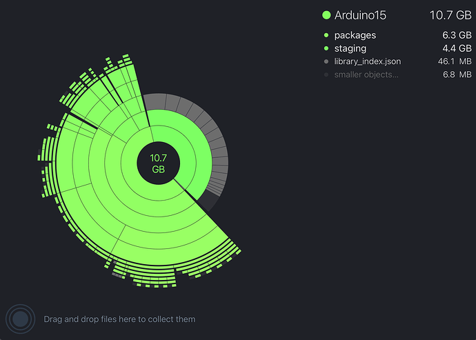

Issue: My Arduino IDE (or related files) is using almost 10 GB of disk space. I have installed some common board packages (e.g., ESP32, ESP8266) and some libraries.
Questions:
  1. Is 10 GB normal for this IDE version on an M1 Mac?
  2. If there are some space i could save, which one i can delete?
Thank you so much

10GB is about right

The libraries you install actually go in the libraries subdirectory of your sketchbook. The ones in Arduino15 are just some default ones.
staging contains the downloaded zips from which packages and libraries are unpacked. these are temporary and you can delete them.
Mine is a lot bigger but I have a lot of boards installed. Since the Mac came with 1TB of SSD I am not the least bit concerned.
Was going to say that if you have the ESP32 core installed, then that will account for at least 2GB of that. Well looking at Ken's stats, make that 3.4Gb. Looking at my installation, its 4.7Gb! I also knew the Arduino board package was getting pretty big, but didn't realise it was almost up to 2Gb nowdays. Quite a bit smaller on mine, but the rp2040 package is taking up quite a chunk. Looks like I have quite a bit in staging as well on mine, but yes, seems like 10Gb is looking pretty normal....

Thank you all for the replies! I definitely wasn't expecting the Arduino15 package folder to take up so much space.
At least I can save up my 4.4GB.
Thanks
