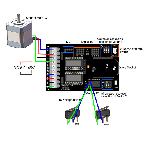

I'm beginner to Arduino, including some electronics, and coding, sorry 😊
My project for now is simple, 1x Stepper Motor to move Clockwise then
Counter Clockwise, triggered by 2x Limit Switches
Problem; limit switches show that they trigger via the Serial Monitor,
but the Motor does not respond by changing direction
 ![IMG_3052.PNG](https://europe1.discourse-cdn.com/arduino/original/4X/6/5/4/654ed07a44f7f1ce9ab600b85b9daea8f953e4a9.jpeg)
![Screenshot 2022-06-15 at 09.12.37](https://europe1.discourse-cdn.com/arduino/original/4X/4/4/c/44cdea61f84da43f49982ee16958cb18e5f24d53.png)
hope i did all of that correct 🙈

You posted a pretty picture but it is of no use to me. Posting a schematic with all the connections as you have wired it will help a lot. Include links to technical data on all of the hardware items. Links to axon are about useless.
<div class="post-metadata">
**Author:** ![gasPhase](https://avatars.discourse-cdn.com/v4/letter/g/13edae/32.png) [@gasPhase](https://forum.arduino.cc/u/gasPhase)\
**Post date:** [June 28, 2022, 2:06pm UTC](https://forum.arduino.cc/t/arduino-2x-limit-switches-stepper-motor-not-changing-direction/1007343/5 "2022-06-28T14:06:06Z")
</div>
to me everything schematic wise shows in my pretty picture,
please show what in a schematic will show what the picture
does not?

for interest sake this was the pretty picture from
[ArduinoGetStarted.com](http://ArduinoGetStarted.com) where the code and
instruction were (their wiring on the limit switches
seemed weird, i still tried it, it didn't work)
 ![arduino-stepper-motor-two-limit-switch-wiring-diagram](https://europe1.discourse-cdn.com/arduino/original/4X/2/e/e/2ee6710b259344ebd8674ce99e7603363d8b9253.jpeg)

Print out _targetPos_ after this line and see what you are getting:
```cpp
    case STATE_MOVE:
      targetPos = direction * MAX_POSITION;
It seems like your connections are good since you are seeing the correct values reported earlier in the program.

I am a fan of hardware be-bounce as well. Very easy to do and reduces one source of gremlins. 👍
Though may not matter much for a limit switch, except if using it to zero out your axes, may get minute errors. Which again may or may not matter depending on how much your program is relying on machine zero.
**Author:** ![groundFungus](https://avatars.discourse-cdn.com/v4/letter/g/73ab20/32.png) [@groundFungus](https://forum.arduino.cc/u/groundFungus)\
**Post date:** [June 30, 2022, 2:22am UTC](https://forum.arduino.cc/t/arduino-2x-limit-switches-stepper-motor-not-changing-direction/1007343/18 "2022-06-30T02:22:45Z")
</div>
@cncnotes, doing the 2 step home\* like grbl, Marlin and others do would seem to minimize those errors.
\*fast to the limit switch, back up and slow back to limit switch then stand off.
**Author:** ![Wawa](https://dub1.discourse-cdn.com/arduino/user_avatar/forum.arduino.cc/wawa/32/1211303_2.png) [@Wawa](https://forum.arduino.cc/u/Wawa)\
**Post date:** [June 30, 2022, 5:02am UTC](https://forum.arduino.cc/t/arduino-2x-limit-switches-stepper-motor-not-changing-direction/1007343/19 "2022-06-30T05:02:59Z")
</div>
> [@groundFungus](#):
> Another function of software debounce is to verify that the closure was a valid switch action and not noise...
But this is a limit switch, and you should use an opening contact, for safety.
An opening contact is more reliable than a closing one.
Leo..
**Post date:** [June 30, 2022, 5:31am UTC](https://forum.arduino.cc/t/arduino-2x-limit-switches-stepper-motor-not-changing-direction/1007343/20 "2022-06-30T05:31:44Z")
</div>
I don't like running hot wires all over the machine. Seems, to me, running ground to the switches is somewhat safer. Every 3D printer that I have worked on uses grounded switches so there must be something to it.
**Post date:** [June 30, 2022, 5:43am UTC](https://forum.arduino.cc/t/arduino-2x-limit-switches-stepper-motor-not-changing-direction/1007343/21 "2022-06-30T05:43:27Z")
</div>
Yes, IMHO the switch should be between pin and ground,
with internal pull up, and a 10n cap across the switch to kill RF.
Normally closed, and opening when the limit is reached.
Leo..
