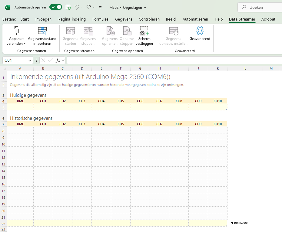

As you might or might not know, the excel streamer only shows 10 channels from default.
I have made a menu with more then 20 different settings, which i want to register into the datastreamer. But i cannot find how i can expand the 10 channels into more channels

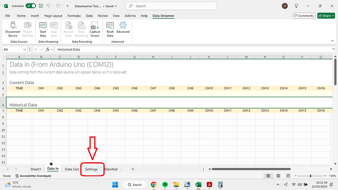

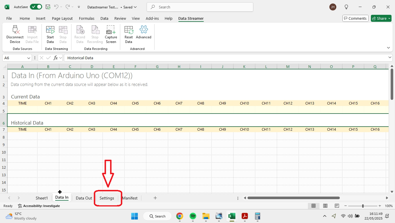

Go to the "Settings" Tab. (Sorry, I don't know what it is called in your language, Is it "Instellingen"?).

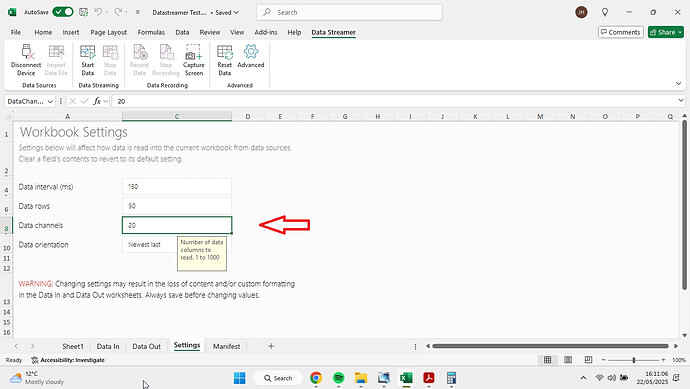

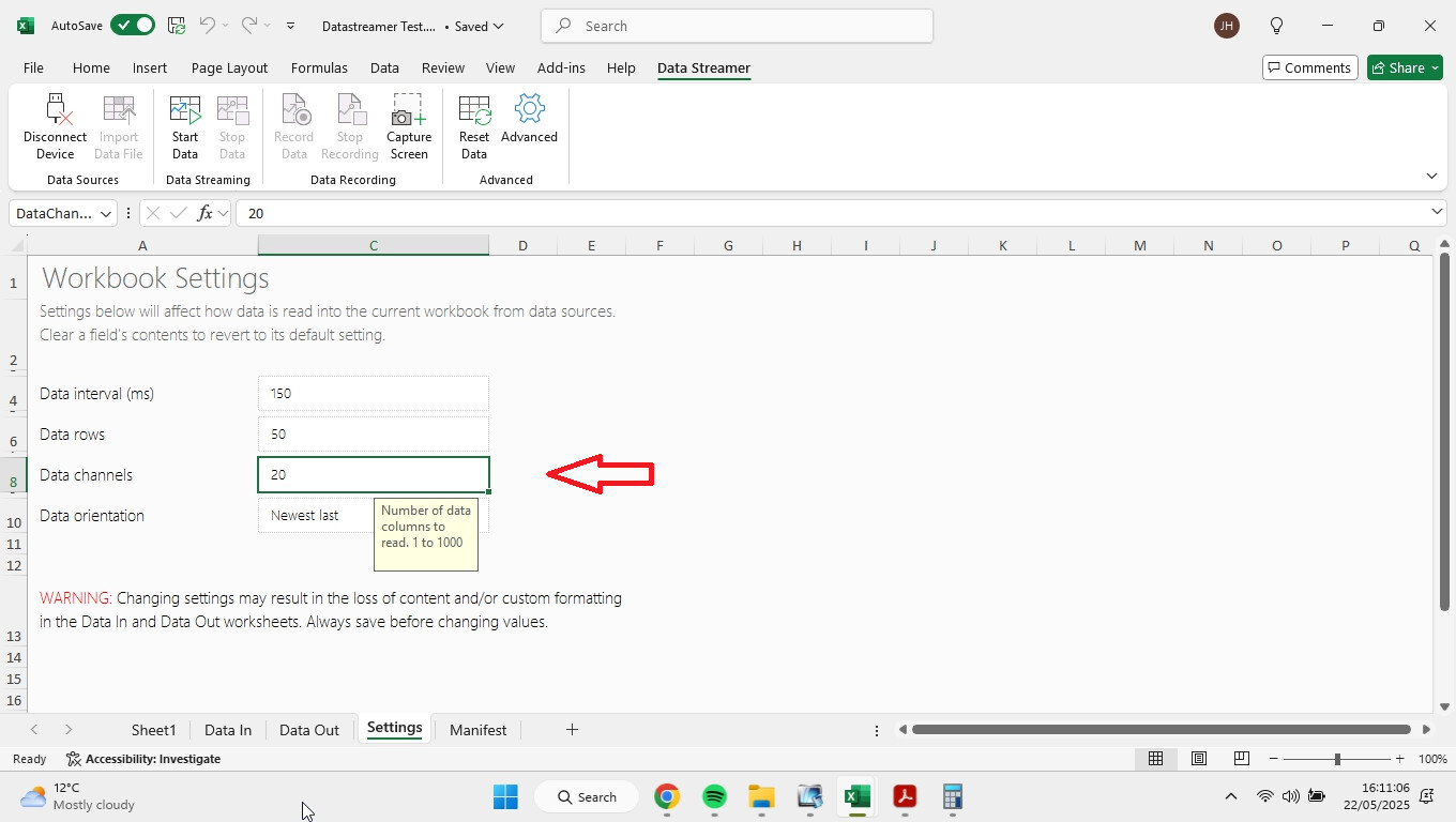

Then you can set the number of Data Channels:
The pop-up message says you can have up to 1000 channels.
