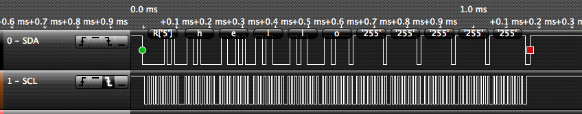

Testing your sketches I don't see the NAK until the 10th byte.
The NAK is the red square.
  Wire.requestFrom(2, 10);    // request 6 bytes from slave device #2
The evil comments strike again!
Hmm, the red dot is the stop condition, but even so:
I'm wondering who is supposed be be NAKing? After all the slave is sending, so the master has to ACK or NAK, right?
Thus the master is requesting 10 bytes, and ACKing the receipt of each one (except the last, which it NAKs to indicate it doesn't want any more).

Is that scope for my sketch ? that shows that there is no nack signal after 5 bytes but after 10 bytes that is produced by master not slave. that may explain the problem.
Yes, that was what I was attempting to say. That is from your sketches.

I read the docs as saying that if one end transmits, the other end ACKs or NAKs. So when the slave is transmitting it can't also send a NAK.
