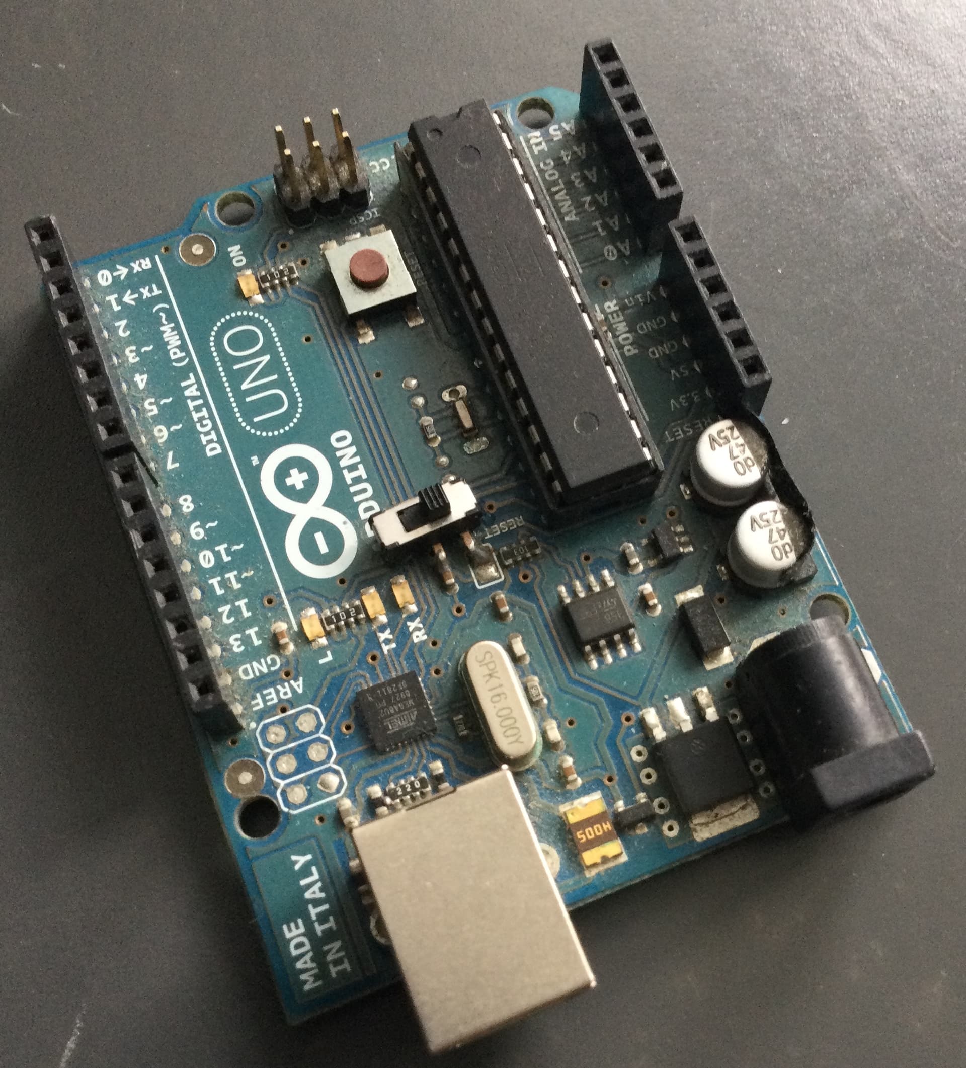

Yes.
Simply cut the track leading to the reset line, and then put a switch on the board that can short out that cut for normal, that is none programming, use.
This is what it looks like on my Arduino Uno.
There is a solder link on the under side of the board that I had to cut as well. This slider just shorts out the solder link I cut, for normal operation.

So @Grumpy_Mike, you have a dedicated Arduino programmer. That switch is pretty neat.
