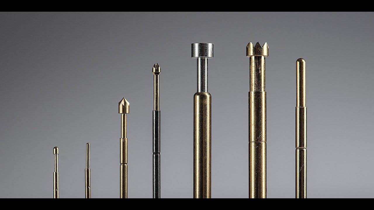

I mean i will design an arduino based system, and it will work like four point probe to measure the sheet resistance and resistivity of wafer (for exp: silicon). I am new to this so i would like to know any ideas, suggestions and guidance if anyone have experience on this :smiley: :slight_smile:
So far i am thinking how to design the 4 probe tip interface to wafer. The current would be around 10mA.
Thank you. Sorry for late reply.
You want what are called pogo pins, these are spring loaded pins, so that you can push them down a bit without bending them. They have a variety of ends, I think you will want the simple pointed ones. They are mainly used for in circuit testing in production PCBs.
