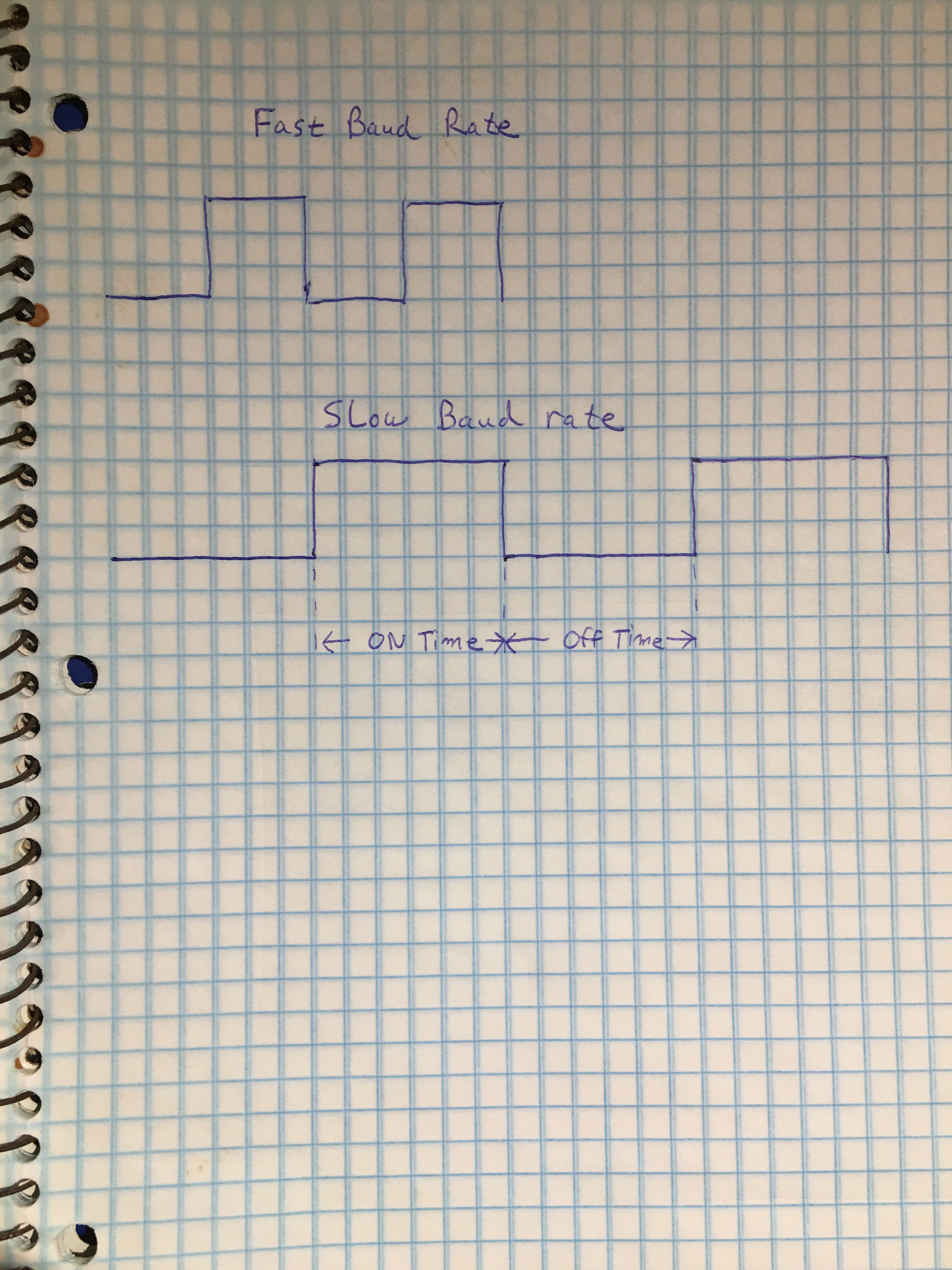

I am new to arduino signal processing and just trying to understand what Baud rate really means.
As I understand it, the baud rate speed is really the time that the processor takes when it is ON and when it is OFF. I attached an image as an example. For a slower baud rate, a 1 is represented by ON and voltage will stay ON and OFF for a long time as compared to a fast rate where the voltage will stay ON and OFF for a short time.
Am I understanding this correctly?
I am looking at transmitting a digital signal through the arduino over a long distance cable. The problem I am having right now is I believe the signal is being distorted because it is modulating too fast. I need the ON's and OFF's to last longer, to stretch out over time. As I understand it this would be as simple as slowing the baud rate down.
Could someone confirm this? Hope it makes sense, thanks.
Consider it confirmed.

Yes, Baud Rate is the rate at which the serial data is clocked. Notice that, minimally, there is only an Rx and a Tx line -- that is all that is needed to do Serial Transmission in the RS232 protocol. But, how does the receiver (the "Rx") know when it's receiving a "One" and when it's receiving a "Zero"? What if more than one "One" is transmitted at once? How does the Rx know how many "Ones" were intended, since all it receives is a continuous High voltage, for some period of time [actually, for a "One" the line goes "Low"]? That's where Baud Rate comes in. But setting the Transmitter and the Receiver at the same Clock rate, there is an agreement, between the two, at what rate the data is being transmitted. That way, that long low voltage period, gets properly chopped up into the correct number of "Ones". And, BTW: the "Start Bit" is what synchronizes the two clocks.
But, for a long line, the problem is likely not the pulse width, but the fact that the pulse gets distorted by things like reflections due to impedance mismatch, ringing due to dominant reactive components, hi-pass filtering due to parasitic capacitance, I2R losses, and etc/etc. Google "Transmission Line", and then step back, 'cuz it's a whale of a topic!!
