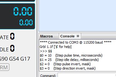

The actual version of GRBL wont matter at this point until we know you can talk to it.
For Windows I prefer to use UGS platform
Most senders seem to work in a similar fashion.
Simple select the COM port you found in DEVICE MANAGER and click CONNECT or whatever your sender uses as the connect option.
Most senders also have a small "console" section near the bottom.
When you have clicked on connect you should see some text appear in there.
What appears may vary slightly depending on the sender but most often it will at the very least give you the version of GRBL.
Pic below is from UGS which gives me all the parameters as well as the version.
If yours says that it connected but nothing shows in your senders console that can be an indication that GRBL is either corrupt or not installed.
Some older versions of GRBL will require you to set the baudrate at 9600 rather than 115200 so make sure you try both.

So I installed UGS and selected com4 and 115200. The screen came up and in the connection box I put the com 4, 115200, GRBL. On the machine status in red active status and alarm showed up. On the machine control tab I checked enable keyboard movement and in the XY step size I put GOX10. Z step size says 10, feed rate says 25. On the console tab when I hit enter I get this. [Error] an error was detected while sending"G90 G21" error:Alarm lock. Streaming has been paused. I looked for some way to unlock but don't know where.
