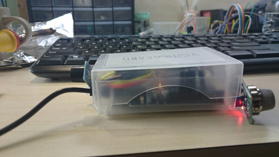

Electronic newbie here…

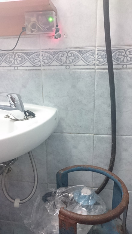

Just finished my first project for a gas sensor with a buzzer.
I’ve used a deck card box and cable jumpers.
I was wondering if anybody had suggestion on how, according to these pictures, I could:
-Use angled cable jumpers or a shield to improve the robustness of the design (please link parts)
-A better box
-Affordable solutions
Any bad comments about my project?
Thanks
If this is a permanent installation I would be inclined to either remove the female sockets from the Arduino and solder the external connections directly to the board, or to use an Arduino board that does not have sockets in the first place and solder directly to that.
This will show you how to keep your Uno board and put your project on a standalone AVR. Make it go on the breadboard then look to more stable packaging -- the connections must be the same.
http://www.gammon.com.au/breadboard
With this, you can fit your project in an Altoids tin or piece of PVC pipe that can hold the gas sensors too.
If you don't want to mess with chips, that same tutorial (and the great software in it) can show you how to program an Arduino Mini, just treat it like a pre-wired breadboard. The Mini has no USB.
If you want to run cable wires outside the box, covering them with heat-shrink tube will make them much tougher but not as easy to bend.
If the sensors can run at 3V, you could set up an AVR to run 8MHz or less at 3V right off 2 AA batteries. You can't do that with an Uno that I know of! Nick's blog even shows how to use the internal oscillator, you don't need a crystal and caps or resonator using that -- less parts.
There are smaller AVR's than Nick shows there that might do the job cheaper & smaller.
UKHeliBob:
Great idea. Yes this will be a permanent solution soon. I don’t think my component are security compliant in any ways, but at least I got something to work with.
Next thing would probably be to get a battery pack.
I just have those 9v. Batt. Connectors. I heard it won’t last long and I need 1.5v batteries in pack.
Any ideas for a DIY batt pack using that connector (see picture) and how much 1.5v batteries, six?

I am looking for an electrical part solution, or any solution at all that allows me to duplicate the 3v and 5v pin on the UNO.
I am running out of "power PIN" connectors. You said there is plenty of power so we got that out of the way.
My cable jumper are already filling up the 3v and 5v PIN, now I want to add a liquid display.
Any clues?
1 gas sensor
1 active buzzer
1 liquid display
I am currently using a 9v. PSU on site plugged in the UNO. Is there any tidy solutions for power distribution?
