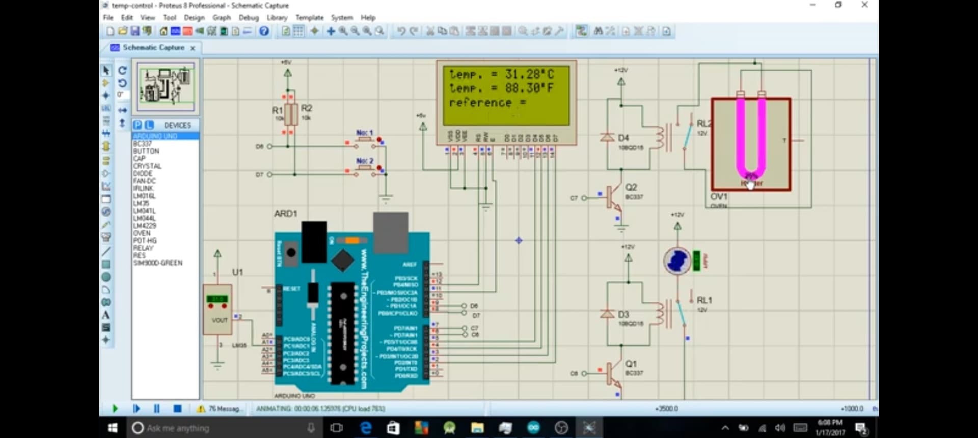

Arduino code for the circuit diagram
Provide an Arduino code for this circuit diagram

What is that big pink U shaped thing?
U shaped thing is not functional, it is either not connected or shorted
The "pink thing" seems to have a label that looks like 'heater', but it is blurred and covered by the cursor.

Tropical fish tank water temperature controller? The indicated temps are however a bit high :grinning:.
The LCD display does not display a temperature on the screen and the fan keeps on running. Please help me what is the problem
You need to post your code in code tags
The LOW output voltage may not be low enough to shut off current flow.
Try a 1K ohm resistor from the Arduino to the base of each transistor, and another 1K resistor from each base to GND. Voltage divider. Works for me.

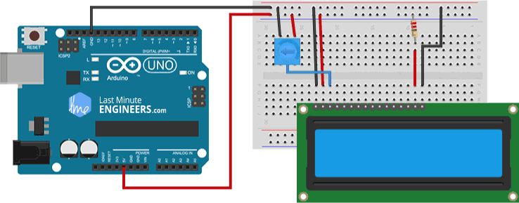

You need to have a variable resistor connected to pin 3 of the LCD module to adjust the contrast.
See this tutorial:
https://lastminuteengineers.com/arduino-1602-character-lcd-tutorial/
for more information.
Testing-16x2-Character-LCD-Contrast-By-Turning-Potentiometer
