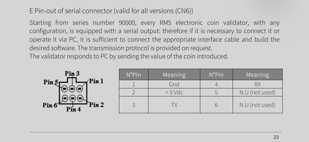

Pin 1 : power 0V
Pin 2 : Power 5vdc
Pin 3 : TX
Pin 4 : RX
Pin 5 & 6 -> n/a

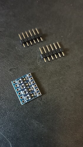

The mkr 1010 is a 3.3V device. Connecting it to 5V I/O is likely to destroy it.
ah! i already have it connected for a while, but yet it says 5v on the 5v pin?

I think it's a connection like RS232 According to some research I did on the net
But on the user manual it is just written what each terminal corresponds to but nothing more

Ok, after some research indeed it is absolutely necessary 3.3v, I am new in Arduino, how to proceed to transform from 5v to 3.3v for RX / TX?
First, you have to know the voltage levels the RX/TX lines on the coin device. If those are indeed 5V, and the I/O pins on the mkr 1010 have not been destroyed, then you can use a level shifter like this:
Measure the voltage on pin 4 of the connector. My guess is that pin 4 transmits information, and would be connected to RX of a receiving device. With a level shifter, if required by the receiving device. For that one way connection, if it is 5V to 3.3V, a resistive divider will work:

I'm going to order the 5v to 3.3v converter quickly, I'm going to bed I see tomorrow for the protocol used, thank you
Here is the user manual it is also possible to connect using 16 pins but I don't know how to do it either. Maybe it's easier than serial :person_shrugging:
According to the manual:
The RM5 Evolution series includes 10 versions with different performances to better meet
the different requirements.
Which version you have?
Hello, I have just received the card that you recommended to me.
How should I proceed to connect the cards?
