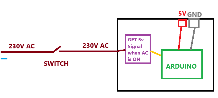

Arduino: Detect if 220V Live Wire is Working or is cut
Voltage is measured between 2 points. If you were using your meter to measure the voltage at your wall socket, you would put one probe in the "HOT" hole, where would you put the other probe? Sticking it up in the air is NOT the right answer.
It will work with either live or neutral, you don't need both
This is what i was looking. What components are used here?
First you need to know the maximum current in the wire.
Wire is comming from a switch. So it will not have a load

I don't see how that is possible. To detect voltage you need 2 connections. Even the tester @arpa123 showed in post #14 has 2 connections: the screwdriver tip and the user's finger.
And, to be clear even my suggestion has 2 connections, the other one being earth via the low voltage part of the circuit. It's such high impedance it probably (hopefully) works even if not connected to earth.
If no load then there will be no current flow, so there is no way to tell if wire is cut or not.
It has two connections. See the two screws.
Have I misread somewhere? I didn't think the wire was cut. Perhaps I missed something.

I think there is confusion here about what you are trying to do, I certainly feel confused. Before I continue please clarify what you want to do.
Also, I'm not clear if you have rejected my idea and don't want to use it, or if you are not sure if it will work for you and want to know more before deciding. Please clarify.
Appears the OP wants to measure the voltage at the load side of a switch without a connection to neutral or earth ground.
i just want to check if switch is on or off (it has 220v AC line)
what i need is a solution for the PURPLE color square in image

Is the PCB ground connected to earth ground? If not, there will be NO current flow, thus, NO voltage difference, understand?
Don't forget to add a 1M series resistor in line with the neon. As a neon once struck has very little resistance and so would blow up.

All you need is a USB power cube and an old USB cable. Cut one end off the USB cable and the red and black wire will give you 5V/GND when the power is on and 0V when power is off. Maybe throw a 10K resistor on the 5V line to limit current, but if you go direct to a digital input, the internal circuitry should be enough.
