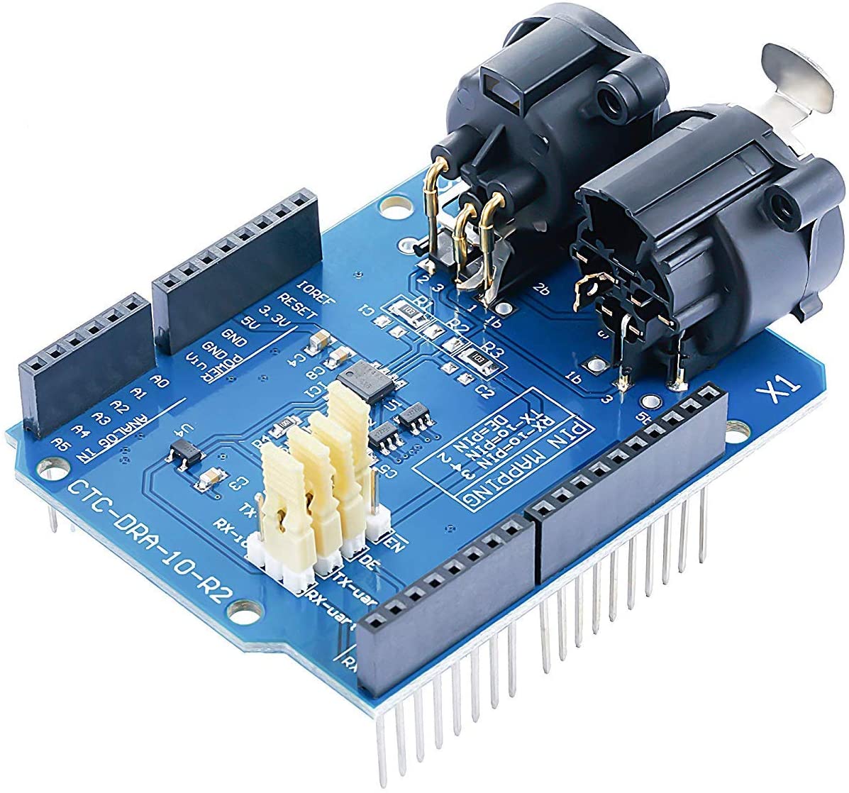

Hi, I've got an Arduino mega 2560 and am using this shield:

I'm using the dmx simple library and it is set up to output on pin 4. I have tried using other pins with a long jumper and the issue remains when it occurs.
The issue:
Sometimes when sending dmx info to my lights from the board and shield listed above, data won't send or it sends random data unless I lightly touch one or more of the pins on the Arduino.

I only chock this up to capacitance since having my finger touching pin 2 or occasionally pin 4 (or the pin that I have designated for the output to the dmx shield which uses a max485 chip without an optoisolator) will make the issue go away. Also unsure if it's just a lack of enough power being supplied.

We need to see the code and the wiring. This sounds like missing pullup or pulldown resistors but could easily be something else.
