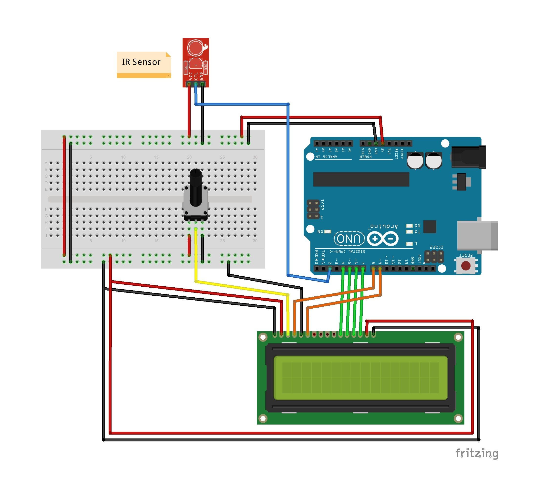

Hello, I have been trying to make a project namely 'Non-contact tachometer' which uses Arduino, LCD, and an IR sensor. The code is running fine and I believe I have made the connections alright yet my LCD doesn't display a thing, I have even connected the 3rd pin of the LCD to a 10kohm potentiometer yet only the backlight of the LCD turns on. I have made the connections as per the image in this link kindly refer https://content.instructables.com/ORIG/FMH/7W5E/IQ8C99Y4/FMH7W5EIQ8C99Y4.jpg?auto=webp&frame=1&width=1024&height=1024&fit=bounds&md=39a88adcc2b6f2607244a9c959373031

If You post a wiring diagram You will likely get answers instead of tons of questions.

Sorry but that's not a wiring diagram. It's a Fritzing painting doing well on the wall. No pin designations on the LCD so impossible to check it.
That can't work, is stone dead, because there's no power to the controller.

An electronic schematic looks like this:
Nobody is expecting you to produce something like this first time out. Many include a hand drawn schematic and that's usually good enough for people to see what you've got. The important information to include is module/component names, terminal name/designation, interconnections, part numbers (like on an IC), power supply voltages.
