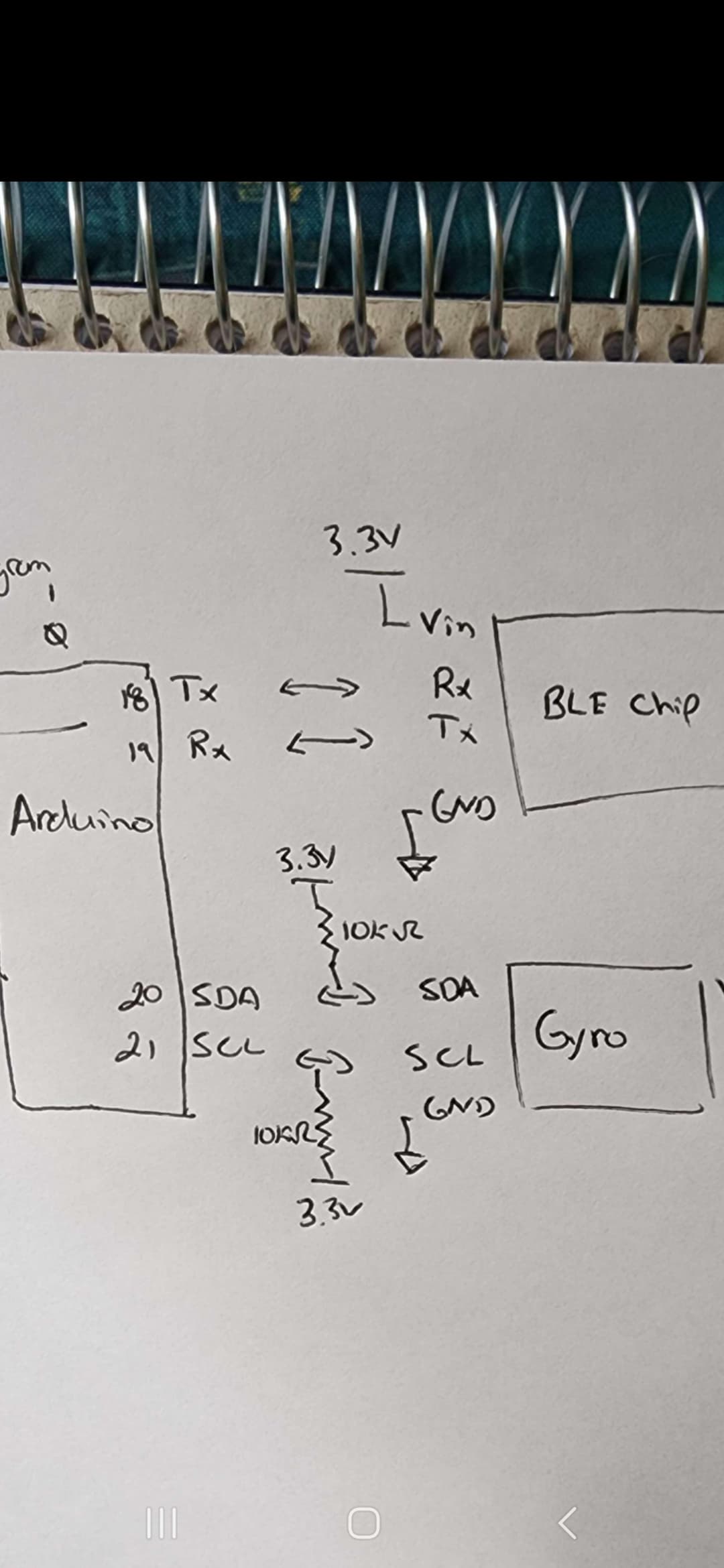

Im stuggling with figuring out how to connect my arduino Due board with the bluefruit Bluetooth device. Im currently using serial 1 on the Due and when i swap it to my Uno board it works fine.
(On the due board it says cannot find device)
Im just using example 1 of the library to test connection.
the Due is a 3.3V device so take care if the external device uses 5V logic
which serial port did you use, e.g. Serial1 on pins 18 Tx1 and 19 Rx1
post your code?
which library?

This is the current code, it includes the other moduel that im connecting too but i only care about the bluetooth currently.

Ive posted the code and libraries below
Also the duo does still work on thos rx/tx pins, theyve been verified with a gps module that uses them.

The Adafruit Bluefruit LE UART contains an ARM processor with 3.3V logic levels so I do not think there is any damage or need for logic level converters.
Study the tutorial to use the device. For example, the tutorial says use hardware UART with CTS/RTS flow control, if possible, but your schem does not show CTS/RTS.
Where is this "on the board"? What happened, where did it say anything and did you try just the example sketch from the library?
I did try the example from the sketch library, i and it work on a Ardunio UNO, i think that theres something with hos the Ardunio Duo reads/takes in communication v.s. the Arduino UNO
I understand that. Why do you think that?
I notice you don't have this line in your code:
Serial1.begin(115200);
maybe try that
