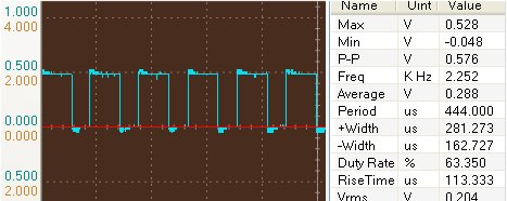

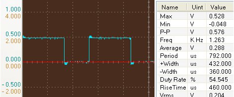

In another application, reading ABS signals, I used an NCV11124 IC chip (Mouser Electronics # 863-NCV1124DG ) to reduce the sine wave to a square wave. In the Arduino sketch I used the pulseIn() function to read the pulse width. Below are some scope pictures of the VSS output conditioned by the NCV11124 chip at 10 mph, 40 mph, and 100 mph. As you can see the frequency increases with speed.
