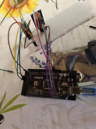

so initialization failed again
my MEGAR3 with sd shield
my MEGAR3 with datalogger shield

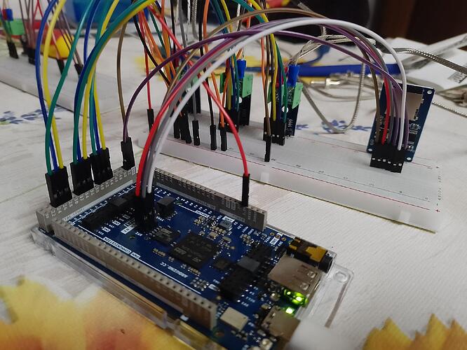

I had a little breakthrough today. As I said I ordered different shields that were available in my country and try some without level shifters and 3.3 input. Today some arrived. I realized I maybe ordered wrong because it says they are for D1 and ESP something. However since I received them and running out of time I tried them out. First soldering the headers, the connecting them I need to browse their ebook:
MicroSD-Shield-D1mini_DE.pdf (2,3 MB)
of course I used the header in the middle of the board,
and pin 53 for chip select that is said to be the pin for mega, not sure if giga, but anyway initialization worked. I have been there with the arduino Mega but couldn`t create a file. So I was curious if I can create a file with this sd card shield and I jumped when my serial monitor said temperature logged sucessfully.
there was no line to close the file though but I disconnected giga from my notebook power supply and was opening the card on my notebook. indeed there was a file with temperature data.
I write this in case someone has the same problem. Try different shields.
